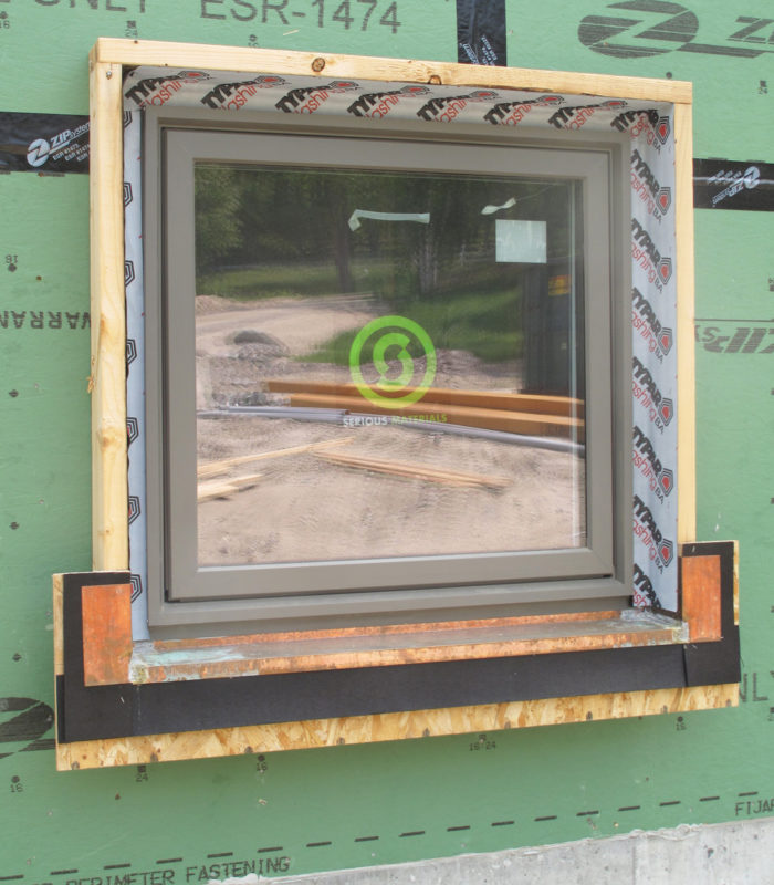

This innie window has a durable copper sill. The photo was taken before the rigid foam layer was installed on the exterior side of the Zip sheathing.
Image Credit: Image #1: Martin Holladay

Step one: Decide whether you want innies or outies
If you aren’t familiar with the distinction between “innie” windows and “outie” windows, you should read this article: ‘Innie’ Windows or ‘Outie’ Windows?
Each approach has advantages. Outie windows provide deep interior stools that many homeowners appreciate, and outie windows are (arguably) easier to flash and easier to trim on the exterior. On the other hand, the innie approach does a better job of protecting window sash from the weather, and innie windows perform better from an energy perspective. If you’re planning to install mineral wool insulation on the exterior side of your wall sheathing, innie windows make the most sense. (For detailed instructions on installing windows in a wall with exterior mineral wool insulation, see Roxul ComfortBoard IS Installation Guide.)
Step two: Determine what material to use as your WRB
Once you’ve decided between innies and outies, you’ll discover that this decision will influence the location of your WRB. If your building has innie windows, you probably won’t be using the rigid foam as your WRB. Instead, you should use…

    For outie windows with no plywood buck:
    (1) Step #2 is to install housewrap, but step #3 is that sill pan flashing should cover the foam, directing any water to the surface of the foam. Why are we not flashing over the housewrap, and directing water to the outside of the wrap?
    (2) Step #3 is to "flash the rough opening". Does that include the sides too? It's not clear, especially as the steps for an outie with a buck explicitly say to flash the bottom but make no mention of the sides, indicating that at least for that installation, the sides aren't flashed.
    For outie windows with a plywood buck:
    (3) Are the sides of the buck indeed not flashed?
    (4) "The housewrap should lap over the peel-and-stick flashing." What do you mean, it should "lap" over the peel-and-stick flashing? In the previous sentence, you said to install the housewrap over the foam, so the housewrap is already on top of the foam, so what further effort is needed to "lap" it? Or is the lapping directive just a redundancy?
    (5) "Under the window, the peel-and-stick flashing should lap over the housewrap." What peel-and-stick flashing? We already flashed the rough sill long ago. Do you mean that after installing the housewrap, I should put a new piece of peel-and-stick over the bottom window flanges (if any) and the housewrap?
    (6) If I read you correctly the installation order for outies is:
    No buck or frame: install housewrap, flash the opening, install the window, flash the window (sides & top).
    With buck: flash the opening, install the window, flash the sides & top of the window, install the housewrap, flash the bottom of the window over the wrap.
    (a) Is that right?
    (b) Is it bad to follow the "no buck or frame" order when installing windows with a buck? If so, what's the potential negative consequence?
  11. GBA Editor
    Martin Holladay | | #11
    Response to Michael Lutkenhouse
    Michael,
    Thanks for your questions. You have pointed out some ambiguities in my instructions, and I'm grateful for you observations.
    Q. "For outie windows with no plywood buck, step #2 is to install housewrap, but step #3 is that sill pan flashing should cover the foam, directing any water to the surface of the foam. Why are we not flashing over the housewrap, and directing water to the outside of the wrap?"
    A. The instructions cover two cases: the case where rigid foam is the WRB, and the case where housewrap is the WRB. If you are using housewrap as your WRB, then you are absolutely right -- the sill pan flashing should extend to the exterior of the housewrap. I will edit the article to remove the ambiguity.
    Q. "Step #3 is to 'flash the rough opening.' Does that include the sides too?"
    A. Yes. When flashing a rough opening, it is always necessary to flash the rough jambs. The flashing on the rough jambs should always be lapped over the sill pan flashing. This is explained in the section of my article that follows the heading, "Step five: Choose your pan flashing material."
    Q. "For outie windows with a plywood buck, are the sides of the buck indeed not flashed?"
    A. Although my instructions failed to mention it, it's a good idea to flash the sides (jambs) of the window buck. I will edit the article to include that step.
    Q. "For outie windows with a plywood buck, the instructions note, 'The housewrap should lap over the peel-and-stick flashing.' What do you mean, it should 'lap' over the peel-and-stick flashing? In the previous sentence, you said to install the housewrap over the foam, so the housewrap is already on top of the foam, so what further effort is needed to 'lap' it?"
    A. I never said that there was "further effort" to this step, although you need to plan ahead at the sill. At the window head and on the sides of the window, the housewrap laps over the peel-and-stick flashing installed over the window flanges. At the sill, you need to leave some of the release paper on the part of the peel-and-stick flashing that extends out from the site-built sill pan, so that this sill flashing can be lapped over the housewrap.
    Q. "The instructions say, 'Under the window, the peel-and-stick flashing should lap over the housewrap.' What peel-and-stick flashing? We already flashed the rough sill long ago."
    A. The peel-and-stick flashing at the sill is the same peel-and-stick flashing used to create a site-built sill pan. When this site-built sill pan is created, you need to leave some release paper on the tongue of the flashing, so that the peel-and-stick flashing can be lapped over the housewrap later in the installation process. I will edit my instructions to make this step less confusing.
    Your summary in (6) sounds correct to me, but since it written in telegraphic style, it's hard to know whether your summary includes all the necessary steps.
    Q. "Is it bad to follow the 'no buck or frame' order when installing windows with a buck? If so, what's the potential negative consequence?"
    A. You question is confusing. I suggest that you follow my instructions as written (although I admit that there are other ways to install a window that deviate from these instructions). If you choose a method that differs from my advice, that's fine, as long as you have thought through the water-management details and as long as you feel confident in your approach.

    The article states that it is not recommended to frame an outie window with an innie WRB (WRB at the sheathing). Why is this not recommended? Is it due to the fact that you create a potential spot for water to puddle at the head? Couldn't this be solved with a piece of sloped flashing?

    Can you verify that I have this correct. I have 2.5" of foam outside of the sheathing. Windows will be attached through brick flange to a 3/4" plywood picture frame that is bolted back to the studs. Housewrap as the ultimate WRB.
    1) Bolt frame in place
    2) Flash sill with Vycor (or similar) and leave outer portion of release liner on. Paying attention to corner details per videos: https://www.greenbuildingadvisor.com/window-sills-won-t-rot-sloped-sill-or-backdam
    3) Flash sides of opening per videos
    4) Install window
    5) Flash sides and top of window
    6) Install housewrap
    Over-window: tape housewrap to previously applied flashing
    Sides: tape housewrap to previously applied flashing
    Bottom: remove release liner from sill flashing and install over housewrap
    Seems simple enough. Appreciate your "checking my work" though.
  18. GBA Editor
    Martin Holladay | | #18
    Response to Dave De C
    Dave,
    Your description sounds OK to me.
    -- Martin Holladay

  30. rutter04 | | #33
    I’m curious if there have been any updates to the innie process since this was originally written. I am retro fitting a 1997 home (climate zone 3A, Upstate SC).
    For my remodel:
    Prosoco Joint & Seam, Fast Flash, MVP
    Marvin Essential Casement Windows (flanged)
    Rockwool either 1.5”-2”
    3/4” furring strips for a rain screen wall
    I want to pre-build and attach an innie picture frame.
    Ripping a 2x to depth will work but does it screw through the flange?
    What material are folks using, Cedar?
    I know it needs to be water tight before the Rockwool goes up, but should the sill flashing go over the Rockwool? Any break through’s on this process.
    *On a side note, by adding the insulation and furring, it will extend the siding 2 7/8” to 3 3/8” from the brick on the foundation. Any elegant solutions to soften that transition?
