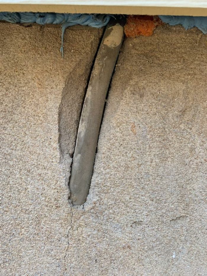

I am one of many in Central Texas that had their pipes burst in the recent freeze.  The outdoor faucet located in a unheated garage wall froze and ruptured.  I had thought I had the situation under control after residing my house and upgrading sheathing to r-3 zip and insulating all walls (including garage walls), however forgot about the original construction that left a small section of water pipe outside of the slab foundation (see photo).
I’m looking into how to try to ensure this doesn’t happen again, and looking for advice.  When we finally repair the faucet I will install a 4″ frost-free faucet with PEX connections, but the freezing is happening on the outside of the wall in the slab.  My plumber suggested possibly jackhammering out the slab and trying to tuck the tubing back into the slab, but I’m really nervous about this as the tubing is already compromised and trying to work with tubing that’s over 40 years old scares me.  My second thought is to install a 2″ or so veneer stone over the slab that would tie into a wash slab under the faucet.  This would provide direct protection for the tubing and probably keep from freezing.  Other ideas welcome.

    Can you abandon that pipe, shut off at the source, and locate the new faucet on an outside wall of the conditioned space (not the garage)? For example, maybe it can come out from under the kitchen sink, if you have a kitchen sink against an outside wall?

    In places where it ordinarily gets below freezing, there are four ways to keep a pipe from freezing:
    * Drain it.
    * Run it below the frost line. If you can't run it below the frost line, the rule of thumb is that an inch of foam is worth a foot of dirt. Extend it for a foot horizontally.
    * Run it through the heated part of a heated building.
    * Heat it. There are thermostatically controlled electric heat tapes that only provide heat when needed. This might be the best solution for a spot that rarely sees freezing. Although it won't help if you lose power.
    Since this is a rare occurrence, do you think you could configure it so you can drain it if frost hits again?

    I think covering it with insulation would work better than covering it with stone. I'd add just enough concrete patch to ensure there's good contact between the floor and the pipe, then covered it with 2" of EPS, then the wash slab over that. This is assuming you are sure that the slab itself will never get to freezing temps.

    Thank you all for your suggestions. Let me clarify some points. The photo is the stem wall not the actual slab, so installation is not possible here. We could abandon the piping, but could only cap it off inside the garage wall, so the tubing still sticking out of the slab would still be exposed in we get another 100 year freeze. Capping it off lower would entail a pretty heavy demolition of the stem wall (pipe should have been just under the slab and not in the stem wall). Since this is the only outdoor faucet in the front of the house, and since it tee's off of the main line to the rest of the house, capping it is not the easiest solution. The garage is actually well insulated, with R-15 Rockwool insulation in the walls, a R-13 door and ceiling insulation. Eventually I'll add a mini-split to facilitate year-round woodworking. So the pipe is well protected inside the wall, just not here at the stem wall. Possibly just letting it drip or getting a heat lamp on it (assuming we keep power next time) is the best solutions. But still considering the stone veneer to provide some cover and protection to the pipe. Again thanks for taking the time to comment.

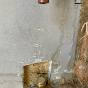

      No the whole house is copper plumbed and the faucet was covered and insulated. It froze just above the slab inside the wall cavity. I'm enclosing a pic of where the pipe was capped, just barely above the sill plate. If it had been much lower, it would have really been a disaster.

        Looks like a shark bite cap save the day there :-) Those are probably the absolute best application shark bite fittings -- quick and foolproof when you need it to just work.
        Regarding your semi-enclosed pipe, you could potentially insulate that part of the wall with some rigid foam to add some thermal protection for the pipe. I would try injecting canned foam around the pipe, trimming it flush with the wall, then adding some extra rigid foam over that to get up to whatever level of protection you desire. The canned foam will prevent air circulation around the pipe, and thus protect you from convection currents cancelling out the benefits of your other added insulation.
