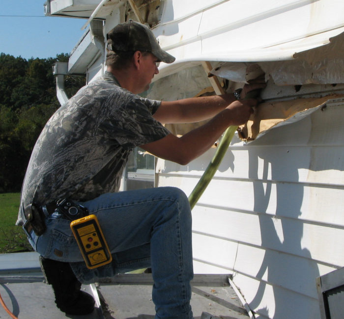

Insulate wall cavities with dense-packed cellulose
Filling the wall cavities. The easiest way to insulate empty wall cavities in an existing house is to blow in cellulose insulation through holes drilled in the exterior sheathing.

Filling empty wall cavities with cellulose is a cheap, easy, effective way to warm up an old house. Blowing insulation into existing wall cavities is an art, to be sure, but many contractors have been doing it for years. By checking the quality of the job with an infrared camera, an insulation contractor can verify that all voids have been filled.
