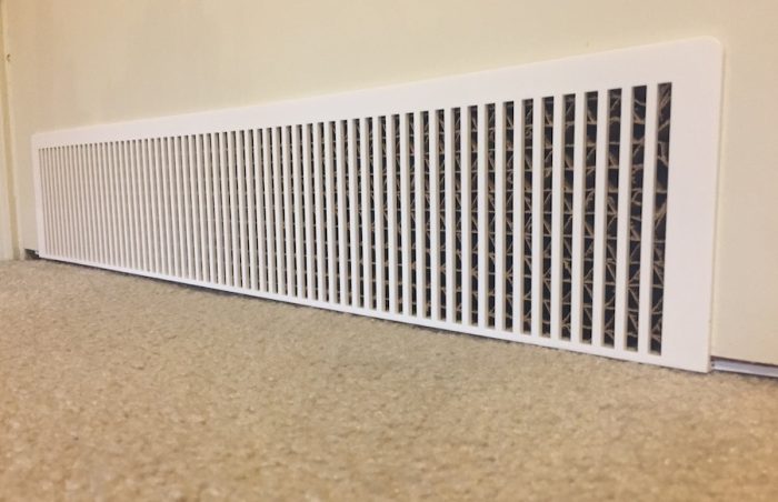

This one may not be so obvious to you. Think of what your ducted heating and cooling system does. The diagram below shows air being blown out of supply vents and pulled into a single return vent. You may never have thought of it this way, but even though you can’t see it, there’s a duct connecting the supply vents to the return vents. It’s called your house.
Trunk-and-branch duct system with return and supply ducts
The only problem with that duct called your house is that sometimes it gets blocked. If one of those supply vents is in a bedroom with a closed door, what happens to the air being pumped into the bedroom? For the system to work properly, that air needs to make its way back to the return vent. So it needs a return air pathway. The lead photo at the top shows one called the Perfect Balance by Tamarack.
When a duct system doesn’t have a return air pathway, the bedrooms build up positive pressure when the doors are closed. The area where the central return is develops a negative pressure. And negative pressures suck, literally. They can pull in outdoor air. They can pull in bad air from the garage, crawlspace, or attic. They also can pull in humid outdoor air, exacerbating any moisture control problems already in the home.
Worse, negative pressure inside the home can backdraft an open fireplace or natural draft water heater. Pulling in exhaust gases from a wood-burning fireplace can put soot and other combustion products in your home. Pulling exhaust gases from a gas water heater into your home can have you breathing carbon monoxide.
Unbalanced pressures inside the home can have a huge negative impact on your indoor air quality. Make sure you have return air pathways for ducted heating and cooling systems. And be careful with a range hood that exhausts a lot of air. You may need a makeup air system for it if you’re not willing to give it up.

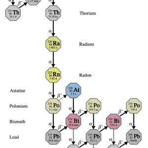

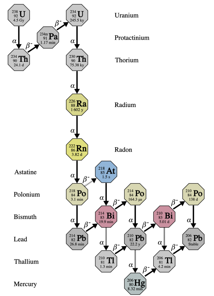

        Malcolm: Yes, some granite does contain uranium (as well as some of its progeny) in it, but the amount of radon it contributes to an indoor environment is tiny. Its half-life is 4.5 billion years, so the amount of radon eventually produced will be close to zero over the life of a house. The U-238 decay chain below shows the half-lives of each element along the way to the first stable isotope, lead (Pb-206).
        But your point about natural vs. synthetic materials is still valid. There are some natural materials you really don't want in your home. Asbestos and lead come to mind.
