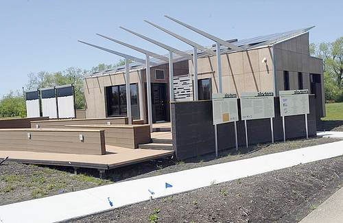

My friend Justin Jones of Building Performance Solutions sent me a link to this article about a demonstration house in Troy, Michigan, that apparently was designed to show the public how to build a grid-independent project. After reading the article and the range of follow-up comments, I honestly don’t know what to think about it. On one hand, I (sort of) understand the value of research projects that are designed to test out theories that are not practical with the hope of gaining knowledge that leads to future benefits. On the other hand. . .
First of all, it doesn’t appear to meet the basic standards of housing—pipes that froze the first winter made it unusable. Second, it isn’t serving as an educational tool—they canceled scheduled public tours. Finally, who knows what they did in terms of tracking the building’s energy use? I have been in construction long enough to understand—and accept—that mistakes are made, but this thing seems to be approaching the status of the military’s $900 toilet seats. People are building plenty of zero-energy and net-zero-energy homes for a fraction of the cost of this. Who decided that it was appropriate to spend close to $1 million on a demonstration home like this?

  1. homedesign | | #1
    It's The Architecture
    Carl, I enjoy all of your blogs.
    Take a look at the floor Plan for the project that you mentioned.
    The construction drawings are here.
    http://www.solardecathlon.org/2007/team_lawrence.html
    This was a solar decathalon entry that was transplanted to Troy.
    Just look at the amount of wall surface area to floor area ratio.
    Look at the window to floor area ratio.
    This project was doomed from the start.
    Talk about a radiator.
    I blame it on the Architecture Schools(not all but many).

  3. M Heizer | | #3
    The "Duh" moment
    It's a shame that the folks in Troy didn't understand that the home was designed to win a contest in Washington, DC in October, not Troy, MI, in mid-winter! (and shame on the design team for not raising a stink before Troy accepted the house. Shipping the home a couple of times and a few thousand miles probably didn't do much for the weatherization either).
    Carl said it best: flubs like this give the "denialists" more ammunition to detract. As a side note, "detractors" better describes than "denialists": They don't have to deny anything. The more they can keep our attention on other issues, the longer they can keep the status quo (and encourage the "denialists" who think the green movement is some world conspiracy). "Pay no attention to the environmental damage behind the curtain"
  4. solarhouseparticipant | | #4
    Missing the Point
    I think you all are missing the point. This competition is one of the best opportunities presented to college students. Yes, we are students, so no, the homes can't be perfect. We're sorry. However, coming in with no knowledge on solar or any green building for that matter, and leaving pretty much experts in our systems is a pretty large feat. I'm confident that our thermal systems designer could go out and create "green" thermal systems for a living better than most mechanical engineers with years of experience.
    As for the pipes, we try to design for all weather assuming the house will be placed somewhere permanantly, but we are still trying to win a competition, so there is optimization.
    To Martin, we are now tied to the grid for the competition.
    As for the cost of the house, none of these houses cost that much to build. Our budgets are all set around a million dollars, but the houses are priced around $300,000. We do have to transport the homes to DC, pay students over summers, etc. We do try and build cost efficient buildings and do hours of work on low-tech solutions, however again, it is still a competition.
    Overall, we're trying to educate the general public on issues relating environment and green building. It is extremely hurtful to see comments like these stating that we're giving "denialists" more ammunition. We're trying our best to do outreach programs and educational solutions all the time. Our team has already reached local communities to change residential homes around campus to be greener.
    I hope you reconsider your feelings toward this project. Every year, approximately 6,000 students participate in the Solar Decathlon and I gaurantee a good fraction of those students move on to green jobs. I know I am.
    This is the best experience I've ever been given. Thank you Solar Decathlon.
