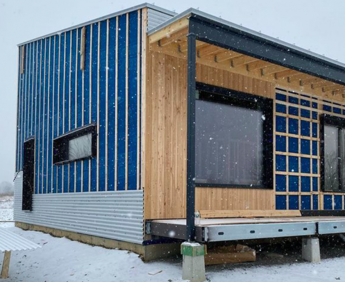

The roof and walls were insulated with dense-packed cellulose and detailed with INTELLO Plus for air and vapor control.
Since our last check-in, Everett has installed the windows and doors, insulated and air-sealed the entire envelope, built the exterior steel structure and lower roof, polished the slab, nearly completed the deck framing, and started in on the electric and plumbing. Of those things, the windows were probably the most exciting.

    I like this project a lot.
    At this stage the devil is in the details and I wish we could see things like how that almost flat porch roof is flashed against the house, the ledger detail of the deck, and how the corrugated steel siding is finished at openings and corners which are typically flashed before the panels are installed.

    2. Everett Kramer | | #6
      Hi Malcolm, you're right, these are all issues we've been really focused on over the past few months. You might see more of it on my instagram account @thehomesteadmodern. One answer to your points is we have a vented deck ledger and porch roof ledger, meaning we installed our vertical rain screen battens prior to those structures and then installed the ledger over the battens, in addition we have the deck ledger fully flashed with metal flashing. The nearly flat roof has Grace ultra as well as metal flashing going up the building. If any water does ever get behind that though, it can drain all the way down to the ground.
