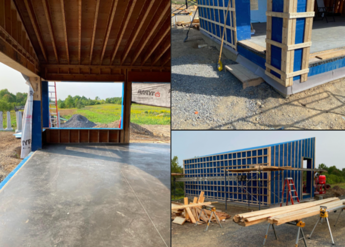

Everett Kramer is not a builder—by trade, anyway. Yet building science drives his every decision these days. He designed this house for his family, and is well into its construction. Located in Germantown, NY—climate zone 5—the three-volume shed-roof structure is intentionally simple for two reasons. First, it makes things easier for the first-time builder. And second, it supports Kramer’s hope for a carbon-neutral house operating at near-Passive House levels. He also admires modern design, and wants the house to be practical for a farming lifestyle.
Kramer put three years of research into his design plans, which include a 2300-sq.-ft. main house, a 430-sq.-ft. studio/office/guest house, 1000 sq. ft. of combination deck/patio space, and a garage.
Of course, cost was a consideration. “I spent a few years nerding out about Passive House and strategies for building a super-durable, low-maintenance home,” he says. “After looking at lots of options for prefab and predesigned houses, I decided I could save a lot of money on the project by designing and building it myself.”
Although he started out aiming for Passive House performance, his thinking changed after reading about the Pretty Good House on GBA. “That made a lot of sense to me—using Passive House principles but not being completely attached to all of it,” he explains. His mindset allowed for some flexibility, as in the case of the large lift-and-slide doors, which don’t meet Passive House standards but they enable the house to be smaller. When they are open, they create 10-ft. openings in two walls, which results in one large space connecting the main house to the studio. “We get this big house when everything is open in the summer and we are entertaining,” Kramer says, “but in the winter, we close it off and…

    I’m curious about the rainscreen over the roof deck. Does this mean there is no ccsf below the roof sheathing and no rigid foam above? In other words does a rainscreen above the roof deck qualify this roof design as vented?
    Thanks,
    Aaron
    1. user-7783843 | | #5
      Hi Aaron,
      It's sort of a hybrid, we have 16" deep I joists forming our roof structure and those are going to be filled with dense packed cellulose. Our WRB, Solitex adhero completely wraps the roof sheathing and connects to the walls. The idea is that our WRB is airtight, but it's also vapor open. Eventhough it's not "vented" to air, water vapor can dry up through the assembly. The double rain screen should help to wick away that moisture. As the sun heats up the air in the rain screen it should constantly be drawing up and out and pulling with it any moisture.

    Nice project, with some really well thought out details. I particularly like the idea of raising the slab, and continuing the exterior wall down outside it.

    Venting your roof above the sheathing rather than below is certainly an unconventional approach. But cellulose adds resiliency and Im sure you will do an excellent job of providing a bomber air barrier on the underside of your I joist rafters.
    If you haven't insulated yet, it would be great to attach moisture sensors to the underside of your roof sheathing for ongoing monitoring. If this assembly can succeed (as I suspect it will) then it constitutes a much more simplified method of building cathedral ceilings.
    1. user-7783843 | | #12
      Thanks! Yes, I’ve definitely been thinking about sensors and where to put them. I’ve been looking at Omnisense, if anyone has experience or advice on sensors and best locations, I’d love to hear it!
    2. tjanson | | #14
      The roof assembly is not much different that an air-sealed baffle, as described in this FHB article:
      https://www.finehomebuilding.com/project-guides/roofing/ventilation-for-the-prohome-roof
      The FHB assembly is ventilation baffles built out of ZIP sheathing with joints sealed with can foam. Celluose fills the bays. I've brought this up on GBA before, and from what I have researched, the FHB house assembly is not an accepted best practice as the ZIP is not "vapor open" as, say, a piece of cardboard.. Not any different than decking the roof with zip and filling the bays without venting, and a rainscreen roof, in my judgement. And yet it's published in FHB, so who knows, maybe it works.
        MALCOLM TAYLOR | | #16
        Tim,
        The fundamental difference between roofs vented below or above the roof sheathing is that the moisture in one vented above has to move by diffusion through the sheathing before it can be dispersed by the ventilated air. With a low perm material that is very difficult, so I'd argue that a roof sheathed in Zip behaves quite differently depending on where the ventilation occurs.
        I agree. The roof ventilation is probably most effective placed below the sheathing using highly permeable baffles. Vapour-closed baffles mean the moisture has to rely on moving through the framing members to escape.
        Unrelated to the moisture from the interior, is whether creating a cavity between a metal roof and the sheathing isn't setting up a gap the will cause more moisture to condense due to night sky radiance. My own feeling is: no gap = no moist air.
        As a side note. I'm not convinced air-sealing the baffles makes any appreciable difference. It seems like a lot of work to gain a secondary air-barrier, and prevent wind-washing, which doesn't affect most types of insulation.
