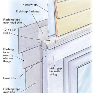

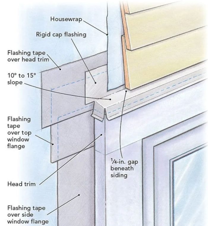

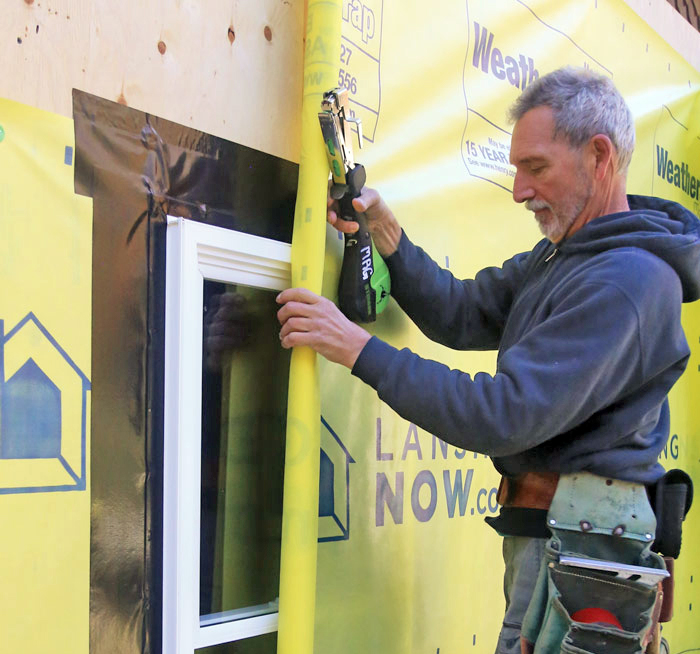

    The photo illustrating this blog of Mike Guertin installing house-wrap around a window with no head-flashing installed, echoes others I have seen on GBA over the years. It's not an option under our code here, but do you know if it is common practice to rely on tape instead of metal head-flashing in many climate zones - and I wonder what you think of that?
    1. MartinHolladay | | #2
      Malcolm,
      I've always been a fan of metal head flashing. For more information, see my 2019 article, All About Flashing.
        MALCOLM TAYLOR | | #4
        Michael,
        Yet again I’ve worded my question poorly. I’m interested in the regional differences, not implying Mike isn’t doing things correctly. My anecdotal experience up here is that in many areas of Canada head-flashing isn’t used. I was more wondering whether it may be a bit like rain-screens, in that it is very useful in many climates, but perhaps not necessary in some.
        Head-flashing deals exclusively with bulk water intrusion, not drying the wall to the exterior. If you have no rain-screen gap to provide drainage for, and the window frame is protected by trim, is head-flashing always useful?
        1. DouglasHorgan | | #5
          Quite late here, but in the US windows are code-required to be installed per manufacturer's instructions (*some exceptions but not super relevant here), and many instructions I've read state that an added metal head flashing is not required. Usually the window has a built-in head flashing piece, or it's like the one in the picture: a unit with welded corners and integrated flange designed to shed water without an added flashing piece. FWIW I've never seen a head failure on a unit that didn't need added flashings per its instructions, at least in my 40"/yr rain climate they seem to perform just fine.
          Yes that was too many negatives in one sentence. How's this: all the windows that say you can install them without adding an additional head flashing have performed fine, without added head flashings.
            MALCOLM TAYLOR | | #6
            Douglas,
            I think you are right - unless you have a rain-screen cavity. Then you need a drainage path to the exterior at the head, and the gap for that to occur needs protection at both sides (end-dams) to stop water moving into the cavity horizontally. I don't know of any windows that could provide that without adding a head-flashing.
