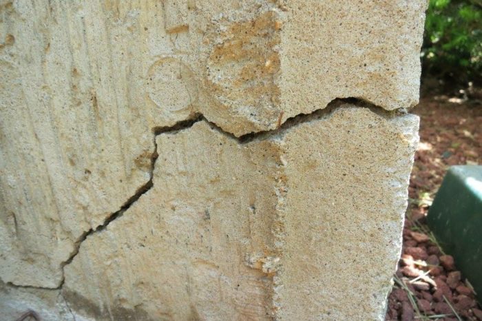

Image Credit: Connecticut Coalition Against Crumbling Basements
Thousands of Connecticut residents whose homes are threatened by failing concrete foundations got some encouragement this week with the visit of U.S. Housing and Urban Development Secretary Ben Carson, who expressed hope that federal assistance might be possible.
As many as 34,000 homes in eastern and north central Connecticut could be at risk because aggregate used in the concrete contained a pyrrhotite, a mineral that in time causes the concrete to crack and degrade. Homeowners face bills of as much as $200,000 to repair the damage, and until now help has been slow in coming.
But on Monday, Carson toured the home of a couple in Willington, Connecticut, whose basement began developing cracks three years ago. Damage has since spread upstairs, and now Maggie and Vincent Perracchio fear the house could collapse, The Associated Press reported.

The rock aggregate bearing pyrrhotite, an iron sulfide, was mined in a Willington, Connecticut, quarry and used in ready-mix concrete supplied by the J.J. Mottes Company for homes built in the 1980s and 1990s, according to the Connecticut Coalition Against Crumbling Basements (CCACB). The state estimates that as many as 30,000 houses could be affected, although the number of homeowners who have filed formal complaints is far lower.
It can take years for the problem to surface. The cost of replacing a foundation can exceed the value of the house, leaving homeowners with crippling financial problems. Insurance claims by many homeowners have been rejected.
