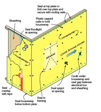

EarthCraft House’s certification program has long focused on promoting construction techniques that result in tightly sealed building envelopes and mechanical systems (click here for a 62-page PDF of its technical guide). Building professionals in Virginia’s Shenandoah Valley say the EarthCraft philosophy has taken root there in part because many prospective homebuyers now have higher expectations for energy efficiency in new homes.
