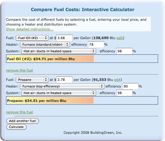

Which fuel is cheapest? This example compares upgrading to a new, efficient propane furnace with keeping the standard, existing oil furnace. Additional heating fuels can be added to the same comparison.

In order to combine all these factors into a meaningful comparison of heating fuel costs, it’s easiest to use an online comparison calculator like one offered by BuildingGreen.
This allows you to enter your cost for a particular fuel, your heating system efficiency, and its distribution efficiency. The end result is a figure in dollars per million BTUs that reflects your real costs of delivered heat and allows you to compare that with other options.
Example: Switch from oil to propane?
I know someone who heats with oil, paying $3.68 per gallon, and uses an older forced-air furnace with roughly 75% efficiency. The heat is distributed through ducts that run through the heated space, with roughly 98% efficiency. Using the online calculator, we can see my friend is paying $36.10 per million BTUs.
Let’s say he wants to upgrade to propane in order to take advantage of the more stable prices, and the 90% efficiency offered by good propane furnaces. With the same ducted distribution, he would be paying $34.51 per million BTUs.
Switching to propane would, in this case, save some money, but not a huge amount, and particularly with fluctuating prices a fuel switch here would be debatable on cost grounds. On a carbon comparison, however the higher efficiency, cleaner-burning propane would be an improvement. I might advise this friend to switch now if he felt really motivated by that, but otherwise to get more life out of his current furnace and in the meantime, work on air sealing and other cost-effective efficiency measures.
