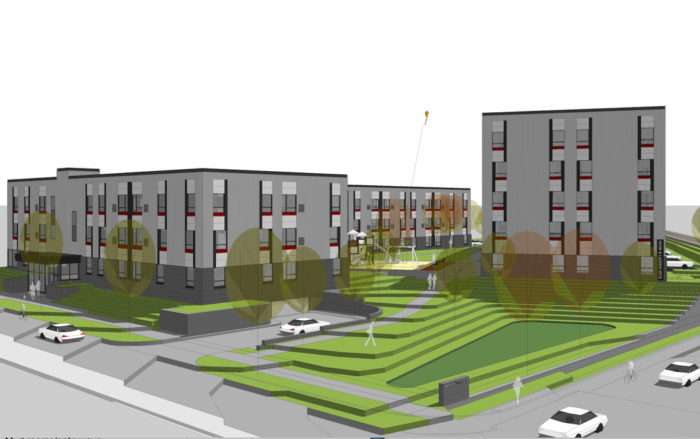

A side by side experiment: These two adjoining apartment buildings in Minneapolis will be alike in many respects — but air sealing, insulation and other building details for half the units will be to the Passive House standard while the other half will be built to code.
Image Credit: LHB Architects
A planned multifamily project in Minneapolis will give designers a chance to see just how much of a difference Passive House construction makes when it comes to energy consumption, if not tenant comfort.
Hook and Ladder Apartments, named after a nearby firefighting museum, is being planned as a pair of nearly identical looking buildings with a total of 118 apartments. Half the project will be built to a slightly enhanced state energy code, the other half to the PHIUS+2015 standard of the Passive House Institute U.S. According to a post at the Minneapolis Star Tribune, Hook and Ladder will be the first Passive House multifamily project in the state.

Both sides of the apartment complex might have been built to the Passive House standard had it not been for the need for off-street parking, Bretheim said. The conventionally built side will have an underground parking garage, while the Passive House side will be built partially on a slab with no below-grade parking. Meeting Passive House specs will add roughly 10% to the cost of that building — about what the underground parking cost on the conventionally built side.
“Pricing we have now shows the cost of the buildings is essentially the same,” Bretheim said. “The difference is that one is Passive House, and one has underground parking.”
Sharing the same site, the two buildings will have the same mix of apartment types, and draw on the same pool of tenants. Because so many building and site characteristics will be the same, Bretheim said, the project will provide an unusual opportunity compare the performance difference between the two types of construction.
