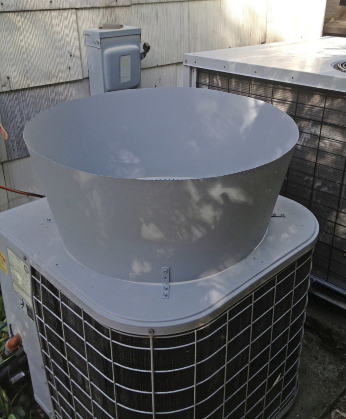

This homemade diffuser improves air conditioner performance. According to researchers from the Proctor Engineering Group, adding a home-made sheet-metal diffuser to the top of your air conditioner's outdoor unit will improve cooling performance, lower energy use, and reduce noise.

To get answers to my questions, I turned to John Proctor, the president of Proctor Engineering Group in San Rafael, California. Proctor is a professional engineer and a nationally recognized expert in residential air conditioning systems.
The short answer to my question is that the outdoor units (the condensers) of split-system air conditioners should have no problems handling a heat wave in Arizona. If homeowners feel hot during a heat wave, the problem is rarely due to a condenser or compressor that can’t handle high outdoor temperatures. Instead, problems typically arise from installation problems (for example, restricted air flow to the outdoor unit or poorly designed duct systems).
“If you have an old compressor that is unhappy — one that is getting ready to go out — what happens is that at high temperatures, the head pressure…

    3) The Funnel. I'd sure like to know more about that. I highly doubt it increases air flow through the outdoor unit since it must by definition introduce a bit of restriction to air flow. What it likely does do is channel widely swirling discharge air further away from the system so that it is less likely to rebreathe its own discharge air when it has been installed in a location confined by vegetation, walls, fences and / or overhangs.

    Q. "I can just see those diffusers full of leaves and junk in no time!"
    A. Good point. I imagine that anyone who installs this type of diffuser will need to perform, at a minimum, an annual cleaning at the beginning of the air conditioning season (February 1st in Florida, and July 10th in Vermont). In most cases, the condenser fan will probably blow out the occasional leaf that falls into the funnel during the summer.

    Assessing the efficacy of a retrofitted funnel (picture looks quite like a galvanized sheet metal agricultural tub with bottom cut out) should be fairly easy:
    Operate the system continually for 15 minutes to achieve steady state. Attach good quality AC current meter and high side refrigerant pressure gauge, preferably a modern digital manifold.
    Note readings, attach funnel, monitor readings. If compressor amps fall along with high side pressure, winner winner chicken dinner. If OTOH, current and pressure rise, remove funnel.

    The diffuser absolutely works. We have tested it many times. We incorporated it into our two high temperature prototypes. it does not increase restriction, it does increase airflow. The science of diffusers is well known and used for years and years. You do not need to measure the increase in airflow unless you are a energy nerd like me. My recollection without going back to the textbooks is that the diffuser helps change the pressure increase across the fan into velocity rather than providing a "backpressure" on the fan. What is more the watt draw per 1000 CFM drops. If you want to see some of the tests go to https://www.proctoreng.com/dnld/01140.pdf Table 21. Also the performance of an air conditioner degrades as the temperature increases nothing magic about 105.

    Who wants to be the first reader to send us a photo of a newly installed home-made diffuser? I hope that someone takes on the challenge -- perhaps next weekend.
  15. watercop | | #15
    DIY diffuser
    Diffusers piqued my curiousity...it just now occurs to me that many, if not most or even all new commercial VRF system outdoor sections feature discharge air diffusers. Those appear to be hyperbolic, rather than straight sided funnels.
    There's probably something to that, given that cooling towers sometimes incorporate a similar feature, and cooling tower performance very much depends on maximizing air flow for a given fan power input.
