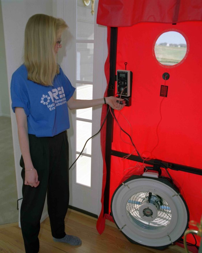

Department of Energy researchers performed blower door tests to see if builders were hitting the airtightness requirements of the International Energy Conservation Code. A high percentage of new homes in sample states are meeting the targets set in the older versions of the IECC.
Image Credit: Warren Gretz/National Renewable Energy Laboratory

  • New houses met or exceeded the requirements for airtightness in all states, with a “high percentage” of observations ranging between 4 and 6 air changes per hour at 50 pascals (the 2009 IECC standard is 7 ach50.)
