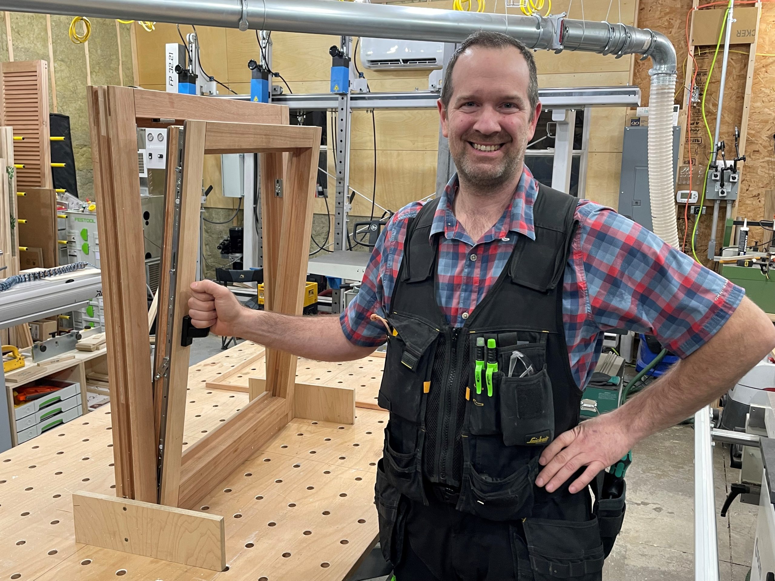

As a general contractor who has shifted to specializing in repairing, reproducing, and building new windows and doors, I’ve taken an interest in the history and production of German-style, tilt-and-turn windows. While this style of window is common in Germany, Austria, and Italy, and in some high-performance homes in North America, it has not yet gained widespread adoption in the housing market here, so it has been an interesting journey to familiarize myself with the history, working principles, and production of these forward-thinking windows.
The author with the prototype wood tilt-and-turn window he built in a course at the Alpine Technical Workshop in Colorado.
This style of window is not terribly common in the Minneapolis area where I work, and since I’m still familiarizing myself with window construction in general, I’ve been traveling to Colorado at least once a year to attend classes at the Alpine Technical Workshop. With small numbers of students and specific, hands-on training, these classes have been invaluable in advancing my understanding of the fundamental construction, fabrication, and function of tilt-and-turn windows.
In addition to the obvious performance advantages that tilt-and-turn windows offer, I’m particularly interested in the “quality of life” improvements they offer to the craftspeople who install and maintain them. For instance, their in-swing sash makes it much easier to service or remove the sash from within the home, as opposed to reaching out a finished frame or working from a ladder, as would be required by a more common out-swinging casement window.

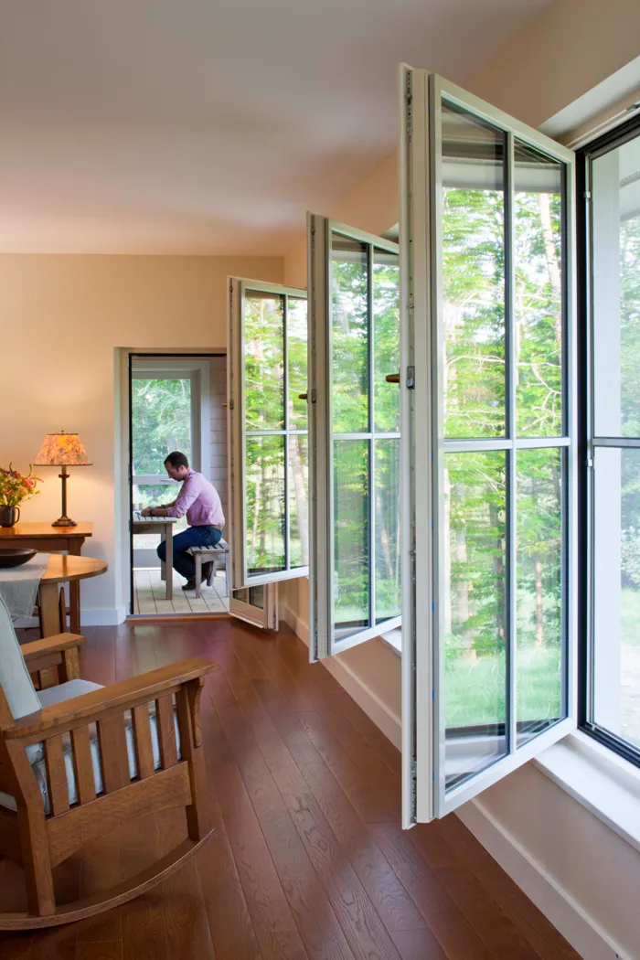

    Thanks for what is a great write-up. Apart from price, the only downside I can see is illustrated by the first photo: The windows opening inward makes the circulation path in that room unusable.
    1. bcade | | #3
      True, although seemingly the tilt function should be adequate for most ventilation needs and would only encroach a few inches. They're certainly not commonplace, however I've come across tilt and slide windows which would mitigate that issue, googling is only turning up the patio door versions like this ttps://dencoeuropeanwindows.com/products/tilt-slide-patio-doors?variant=37981971153070

          I looked up the movie and totally get the appeal of simpler times when designs had fewer constraints, but I don't see energy codes going away any time soon. On the flipside, as someone living in a similar beachside location to the movie, I’d love to have modern windows that can properly seal out the city noise and smell of the nearby sea lion colony when closed. Ultimately I dont think performance and connectedness to the outdoors are mutually exclusive, so long as you have the budget for it. C'est la vie.
          Taking this conversation back to tilt turns, you could always mount them as innies and get them opened ~170 degrees, or like the movie, have a french configuration and a deep projection that gives a good place for the sashes to tuck away when opened. I’d like to think that constraints provide the opportunity to find more elegant solutions, even if they are a compromise.

          Most people who have tilt/turn windows rarely open them as shown; it's far more common to engage the tilt function, and/or use air conditioning instead of letting the outdoor air inside. (Another loss in some ways, not so much in others...) I find that if my clients have not experienced tilt/turn windows, often by spending time in Europe, they can't be convinced of their benefit vs. a slightly lower-performing casement or awning window.
