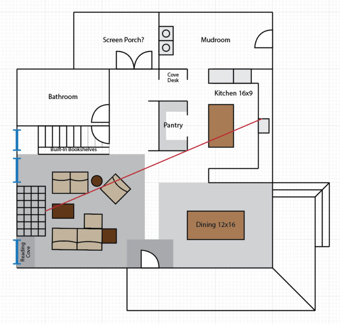

A proposed first floor plan for Mike Sterner's new house in northern Wisconsin. He's looking for a "pretty good house" with either a layer of exterior foam insulation or double-stud wall construction.
Image Credit: Mike Sterner
Too big, too complicated, too expensive — all problems in Mike Sterner’s current home, and exactly what he’d like to correct in the new house he’s planning in northern Wisconsin.
Writing in a Q&A post, Sterner lays out his basic plan for a “pretty good house that finds that happy place between great energy efficiency and economy.”
The site is vacant farmland with a south-facing slope. Sterner’s woodlot has lots of pine and oak he intends to mill for use in his new house.
“I would prefer to stay away from anything too ‘techy’ and have a fairly simple approach to the build,” Sterner says. “It is also my preference that we use materials that are earth and human friendly, with a proven track record. We’re looking at a simple saltbox farmhouse with a single gable, a big covered porch on the east and south, and a shed roof on the back as a rear entry.”
The second floor will have a shed dormer, although Sterner is open to the suggestion of building a full second story it it would be a “vastly better approach” for ventilation and insulation.
His current stumbling block is choosing a construction method for the building envelope.
“I go back and forth between 2×6 framing with a 4-inch rigid foam wrap and a double-stud wall with blown cellulose in both cases,” Sterner says. “I don’t really want to use rigid foam because it is kind of nasty and a hassle to install siding over, but at the same time I am concerned about the double-stud wall cold sheathing and moisture problems. The double-stud wall seems to have questions to me, based on the articles I am reading here.”

    In my area, which is also Peter Yost's area, builders are enjoying using locally milled pine boards as sheathing in conjunction with double stud walls. Correct me if I'm wrong but I think the board sheathing mitigates the moisture issue with fat walls. I second what Martin said about dormers. I try to avoid them as an architect because of air sealing but mostly because they cost more.
    Response to Robert Swinburne
    Robert,
    You're right: Because board sheathing is vapor-permeable, it allows moisture in the wall system to dry outward rapidly.
    GBA often advises builders to consider the advantages of board sheathing. In one of my articles on double-stud walls, How Risky Is Cold OSB Wall Sheathing?, I wrote, "If you’re worried about the durability of your sheathing, choose plywood, DensGlass Gold, or diagonal board sheathing over OSB."
    In another one of my articles, Wall Sheathing Options, I wrote, "Diagonal board sheathing has a lot of advantages for green builders: it’s usually produced locally; it’s strong; it’s vapor-permeable; it resists rot better than OSB; it holds nails well."

    Board sheathing needn't be diagonal, if you add diagonal bracing. In a normal stud wall, that would need to be "let in" bracing, but in a double wall,.the bracing can sit in the space between the two walls, without being let in. How much labor that saves depends on the geometry skills of your carpenter.
    Air tightness with board sheathing depends on another layer, such as house wrap. That is unlikely to be as good an air barrier as.taped sheet goods, unless you go with peel and stick WRB or liquid applied.

    Zip-R sheathing is a perfectly acceptable way to add a continuous layer of exterior rigid foam to your walls. To read more about Zip-R sheathing, as well as a variety of other similar products, see Nailbase Panels for Walls.
    The main caveat is that you have to choose the correct thickness of Zip-R sheathing. The product you select must have an R-value that is high enough to keep the interior surface of the sheathing above the dew point during the winter. For more information on the minimum required R-values (which vary by climate zone), see Calculating the Minimum Thickness of Rigid Foam Sheathing.
