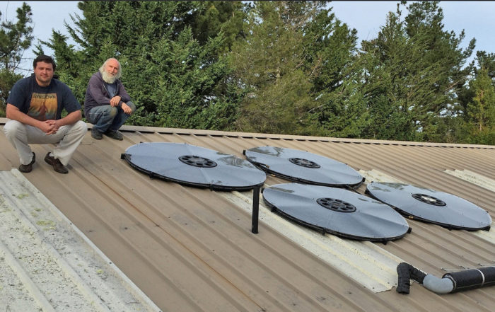

Larry Weingarten and his co-author, Zak Vetter, admiring their solar hot water system on the roof of Zak’s home.

The collectors, each made up of 300 feet of ¾-inch poly pipe mounted to a steel bracket. The Uponor PEX tool and tubing used to connect to the house’s plumbing. PEX is about 4 times quicker to install than copper. Zak Vetter, who is over six feet tall, and the 105-gallon Marathon tank. Goldline GL-30 solar controller and mechanical thermometers. System performance at the spring equinox. System performance at the winter solstice, when it produced water ranging from about 110°F to a little over 140°F. A comparison of winter and spring output, showing the exit temperature of each of the four coils, plus the water temperature at the tank exit.

The project
Enter Zak Vetter. Zak asked me to help design and install a solar hot-water system for his home near Carmel, California. It’s a roof-mounted system on a building that combines living space and shop. He had established a simple set of goals for the project:
  • Greatly reduce or eliminate the need for off-site energy to provide all the hot water desired.
  • Build a system that works well in less-than-ideal conditions. This means that even on a cloudy day, most (or even all) of the hot-water demand is met by the solar energy collected and stored in the system.
  • Build a system that requires nearly zero maintenance.
I had never worked with such a demanding list. Many assumptions go into designing and building a traditional solar-thermal system, and these got challenged by Zak’s goals. Here are some of the assumptions we typically work from:

The collectors
Following is the thinking that got us there. Wanting efficient collectors would have forced us to build a more complex, expensive system, to prevent freezing and overheating. So instead, we used really inefficient collectors! These are just coils of ¾-inch polyethylene tube under an acrylic glazing (see Image #2, below).
There is no insulation in the collectors, so they cannot overheat and are unlikely to be damaged by freezing. The top temperature we’ve measured in summer with no water flow is 170°F in the collectors, and they have frozen many times without a problem. This type of collector has been tested in San Jose, California, for 16 years and no troubles have surfaced. Essentially, they are pool collectors, modified to produce domestic hot water simply by adding glazing. They are commercially made by Gull Industries in San Jose, California.
Each coil measures 26 square feet. Another benefit of using “inefficient” collectors is that we eliminated the need to run copper pipe to and from them, by running PEX tubing instead. With traditional copper collectors, which can stagnate in the summer sun at up to 400°F, PEX tubing would melt pretty fast. But we were able to use poly pipe and PEX for nearly everything, simplifying the job even further (see Image #3, below). We purposely oversized the system, so it could coast through periods without sun and recover quickly when the sun returns.

    To John R., the water pressure from a gravity tank is 35 psi in this system. The collectors I mention in the article that have been under test for 16 years regularly see 160 degrees. The SDR-9 poly tube is rated for 200 psi at 73 degrees. I'd love to use PEX here if it could take the UV, but I don't think it can. Maybe some day, we'll have PEX with sufficient carbon black in it to prevent UV degradation. I know we're right at the pressure/temperature limits of the material, so time will tell. If the system does fall apart, I'll let you all know the error of my ways. Solar contribution in winter is certainly less than in summer, but because of the large storage, the system can coast through multiple sunless days. The system really does meet the hot water need 95% of the time.
    Addressing some of Dana's comments, if we did less to make solar cost more here, no doubt we could drastically cut prices. I remember a presentation given at an ACEEE Hot Water Forum discussing the cost in China of solar systems and it was seeming crazy low at around US $200. The same system in the US was thousands. We add things like permit fees, insurance, import costs, shipping, and multiple markups that the Chinese don't necessarily have. I don't think we'll ever go so low, but it's worth looking at where soft costs can be reduced.
    The goal here was to build a simple and durable system. I'd love to be able to tell you in thirty years that it's still perking along!
    Yours, Larry

    Martin Holladay | | #12
    Response to Larry Weingarten
    Larry,
    Thanks for your very detailed, knowledgeable response. It is much appreciated.
    I'm not going to try to speak for Tim Merrigan, who noted that this "system with plastic pipe falls into the DIY category. It’s not like a contractor-installed system." I'm not sure why he said that. But I'll note one fact: Since the reported cost of the system ($4,369 for parts) does not include pre-construction site visits, labor, insurance, profit, or a contingency for callbacks, the accounting side of your report amounts to a DIY approach, not a contractor's approach. I'd like to hear from a contractor who successfully (and profitably) installed 10 systems like this, so that the contractor could report the price point that makes these jobs profitable to a contractor.

    Solar thermal system parts costs
    Larry,
    One more point: your cost for parts ($4,369) isn't much different than the cost for a two-collector system using collectors made of copper, glass, and aluminum. I'm pretty sure that the parts for my solar thermal system (which included two 4'x8' collectors made of copper, glass, and aluminum, a stainless-steel insulated storage tank, an El Sid pump, and a small PV module) cost less than $4,369.
