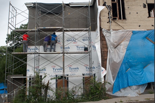

JP Green House is being built for owners Ken Ward and Andrée Zaleska by Placetailor, a design and build firm co-founded by Simon Hare. In a video produced by Ward, Hare shows off 2-in. foam board on an exterior wall and the polycarbonate siding (actually designed as a roofing material) fastened to the shell. Beams were added in the basement to support the concrete floor upstairs. Exterior walls were insulated with blown-in cellulose and foam board recycled from a schoolhouse in western Massachusetts. The old windows were replaced with triple-glazed models with fiberglass frames, made by Thermotech Fiberglass Fenestration, based in Ottawa, Canada.

The builder doing the retrofit, Placetailor, based in nearby Roxbury, used a combination of cellulose and 2-in. foam board to insulate the exterior walls to just over R-50 and the roof to R-63. Placetailor principals Simon Hare (whose retrofit of a 150-year-old house in Roxbury was noted by GBA in a post last August) and Declan Keefe are now focused on sealing whatever leaks might remain before doing final blower-door tests and applying for Passive House certification. As Ward and Zaleska said in an email to GBA, they’re getting very close to the results they want.
