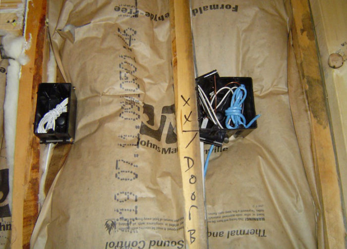

  24. Jonathan Lawrence CZ 4A New Jersey | | #24
    Kohta - who let you in my
    Kohta - who let you in my house to take those pictures?
    I stopped by a house near me that is currently under construction are saw some sloppy work.
