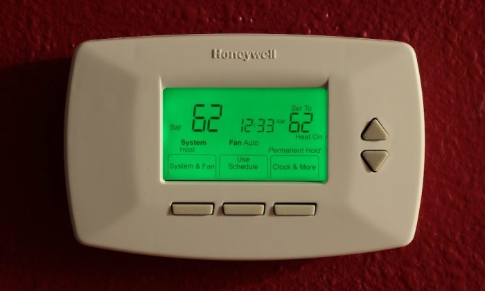

The best ways to set your thermostat depend on a lot of factors [Photo by John Loo, flickr.com, CC BY 2.0]
Let’s talk thermostats today. This ubiquitous device in homes is the user interface that allows people to control their heating-and-cooling systems. It might seem simple. Turn it up when you need more heating or cooling, and down when you want less. But there’s a lot more to it than that. Should you do setbacks to save energy? Should you put the fan in the “on” position or leave it in “auto”? Should you use the “emergency heat” setting? Let’s sort all this out.
