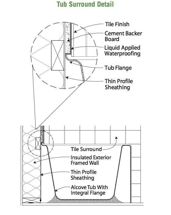

Just as important as the right backerboard is the detailing of the free-draining bottom course of tile.
Image Credit: REGREEN Guidelines (detail by Steve Baczek)

  10. Peter Yost | | #10
    To AJ Builder - thin-profile sheathing and waterproofing recs
    You are right--generic only helps so much. Keeping it generic in this detail is a hangover from days at Building Science Corp. when Building America work meant we were supposed to keep it generic.
    1. "thin-profile sheathing" - this pretty much refers to Thermo-Ply (http://www.berryplasticsbpg.com/products.aspx?page=thermo-ply-total) but it could be any sheathing material that encloses the interior of the tub wall as an air barrier.
    2. "liquid-applied waterproofing" - the one I have used is the C-Cure Pro-Red (http://www.c-cure.com/doc/ds/ds_prored.pdf).
    And taping the seams/joints as the weakest link in the water barrier chain--great idea and thanks for mentioning. I have not used the Schluter system but have heard from many others that it is bombproof.
    PS - I decided not to include XPS-based backer board in this blog because the global warming potential of the XPS is a big issue and we really don't need to get the R-value out of an interior wall sheathing in a tub surround. That said, I should have explained this reasoning in the blog; thanks for catching this.
    Peter

  24. MS | | #24
    Clarfication
    In the diagram it says "just as important is the detailing of the free-draining bottom course of tile" I believe this to mean the bottom course of tile is not run flush to the top of the tub....I have read several options on this "joint" . Namely whether it should be as thin as a 1/16 or as great as 1/4?
    Secondly and more importantly whether this joint is left open. Caulked? Or is grout used?
    If its left open I would say 1/16 may be even to much? Of course you have the "lip behind it" but still having an open seam seems risky.
    Grout seems acceptable in the short term but would think over time will crack and the homeowner would be faced with re-grouting this joint
    Caulk seems ok but would be worried about any inadvertent moisture collecting or running down the and being able to be released as the caulk is blocking it.
    Whats is the author or others opinion on this joint?
  25. Peter Yost | | #25
    that free-draining space at the bottom edge of the bottom course
    In my experience, grouting or caulking the bottom edge of the bottom course of tile does not work; they both eventually fail and hold moisture rather than keeping it out. Leaving grout or caulk out makes the space free draining and much easier to keep clean--it's almost like a shadow line detail.
  26. MS | | #26
    How
    Fair enough.....How big a gap are you leaving? I suppose even flush without it being sealed will allow for moisture dispersion.....or do you leave a gap. If so how much?
