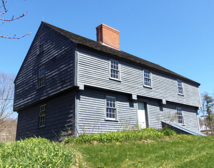

The second-floor joists of a Garrison building are cantilevered. Although some architects like the look of the soffits created by these cantilevered joists, a Garrison overhang is difficult to insulate and air seal.

    The photo of the old Garrison at the top of the page is instructive. The cantilevered joists may be problematic, but the old designers got the roof details right.

    And now I see you are writing to architects to avoid cantilevers, bay windows and dormers... things that make houses pleasant to live in and look at.. Oh Please, Mr. Halladay! Sustainability begins with building homes and buildings that are "lovable" . Simply put, people take care of lovable buildings. They often out last their occupants. Ugly, high performing buildings (envisioned by artless engineers, such as yourself) will not prove to be sustainable.
    Thanks for trying to enlighten architects as to how to design homes. But, I'm afraid i know of NO architects that would agree with your premise. Can you envision the Garrison House without the cantilevers? I can, and can assure you it becomes a boring box! - Not lovable (even if it performs better)
    Stick to your green gizmo's, Mr. Halladay, and leave design and aesthetics - which DO matter!- to those who are qualified to do it!

    Q. "Can you envision the Garrison House without the cantilevers?"
    A. Yes.
    Now that I have answered your questions, perhaps you can answer a couple of mine. Here is the first: "Have you every spent three days on a ladder repairing air barrier defects on a Garrison house, by dismantling the soffits, inserting a rectangle of rigid material above the first-floor top plates at each joist bay, air sealing the perimeter of each rectangle, carefully insulating the overhang, and then rebuilding the soffit?"
    If the answer is yes, then bravo -- you know what I'm talking about. If the answer is no, then I have a follow-up question for all designers (perhaps including you): Did you even know that this type of air-sealed blocking was necessary for Garrisons?
    One more question: "Have you ever worked as a weatherization contractor, repairing air barrier defects?" Again, if the answer is yes, I say, "Bravo."
    My article anticipated objections from designers like you, which is why I wrote: "If you are an architect who wants to include some of the features on this list, my opinions are unlikely to dissuade you. Just make sure that you provide your builders with plenty of detail drawings. And it might be a good idea to stop by the job site frequently to make sure that everything is going according to plan."
    I just hope that architects like you who draw the details necessary for an air-sealed Garrison really understand the necessary details, and really follow up by visiting the job site when the blocking needs to be installed.
