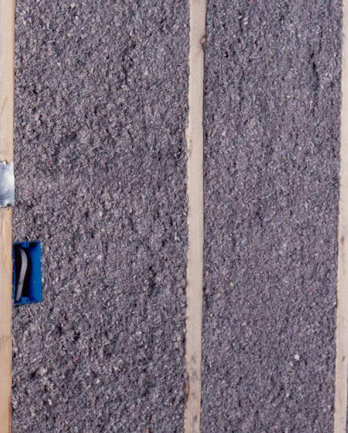

Eric Nash is renovating a kitchen with “old school” 2×4 walls. He’s gutting the room, but not touching the outside of the house. He’d like to present the homeowners with some options for increasing the R-value of the exterior walls while making a better air seal.
Here’s his plan: fill the stud bays with cellulose, add 1 1/2 in. of rigid foam insulation on the inside, then a layer of 1/2-in. plywood on which to hang cabinets, and, finally, 1/2-in. drywall.
How about that? he asks in a Q&A post at Green Building Advisor.
Is plywood necessary to hang cabinets?
Anyone who’s installed kitchen cabinets knows how reassuring it is to have solid material in the walls to catch mounting screws. That’s what the layer of plywood beneath the drywall would accomplish.
But is 1/2-in. plywood enough?
Robert Riversong doesn’t think so. “If it’s only the cabinets you’re concerned about, I would forgo the plywood, install appropriate blocking and use 3-in. cabinet screws,” he writes. “I would rather have cabinets secured to framing than to 1/2-in. plywood.
“You’ll have to move the electrical boxes inward or use deep box extensions,” he adds. “For that, I’ve used plywood pieces attached to sides of studs to attach the boxes.”
David Meiland wouldn’t bother with continuous layer of plywood, either. “But,” he adds, “I might run a 2×4 across the wall at the top of the uppers, interrupting the foam. Tape the 2×4 to the foam.”
Andy Ault, however, favors the plywood route. In fact, it’s standard operating procedure for his crew when they build wine cellars.
“The only difference being that we step up to 3/4-in. ply to increase our holding power,” Ault writes. “Granted, those racking systems have many more points of…
