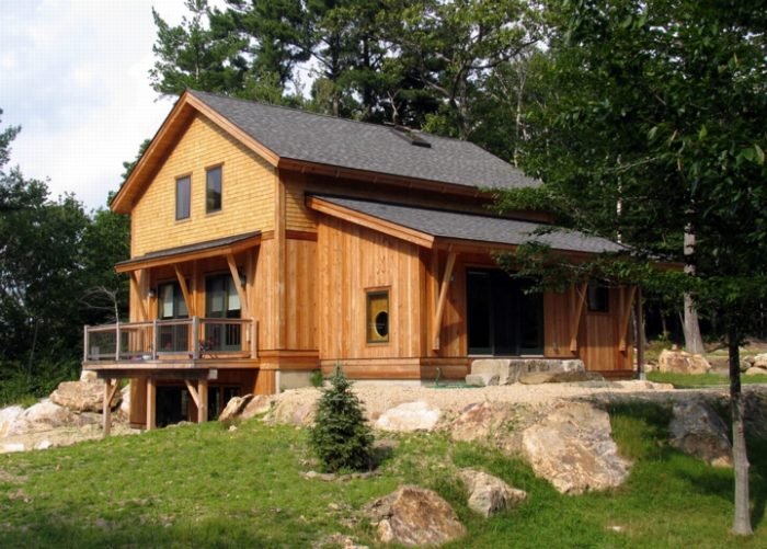

This Bensonwood home in Alstead, New Hampshire combines high-tech panelized construction and superb energy performance with simple elegance. Click on image and scroll through others.
