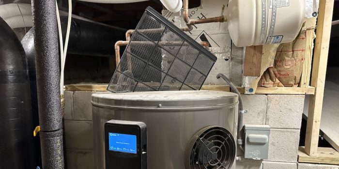

Surprise! Your heat-pump water heater has a filter that needs to be cleaned. But you probably already knew that if you’re reading Green Building Advisor. It’s a thin little filter whose primary job is to keep larger particles from getting into the heat-pump guts of your water heater. It will do a sort-of OK job at keeping the heat-pump coil clean, but it’s not great. And worse, the filter doesn’t fit tightly in the slot, so some air will bypass the filter. So let’s talk about heat-pump water heater filtration today.
The standard heat-pump water heater filter
Gary Klein, one of the most knowledgeable people in the world on the topic of hot water, recently came to Atlanta and stayed at my house. I took the opportunity to shoot some video with him, and here’s part 1 of the two videos we made on the topic of this article.
Yeah, it’s embarrassing to ‘fess up to having such a dirty filter. But it’s been hard to keep up with it during our year-long basement renovation. Actually, that’s a lie. It’s not that hard to clean the filter, and I’ve been surprised how clean it has stayed during much of the work. The reason it was so dirty here is that we’d recently had drywall installed, and that’s quite a dusty process.

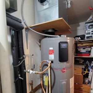

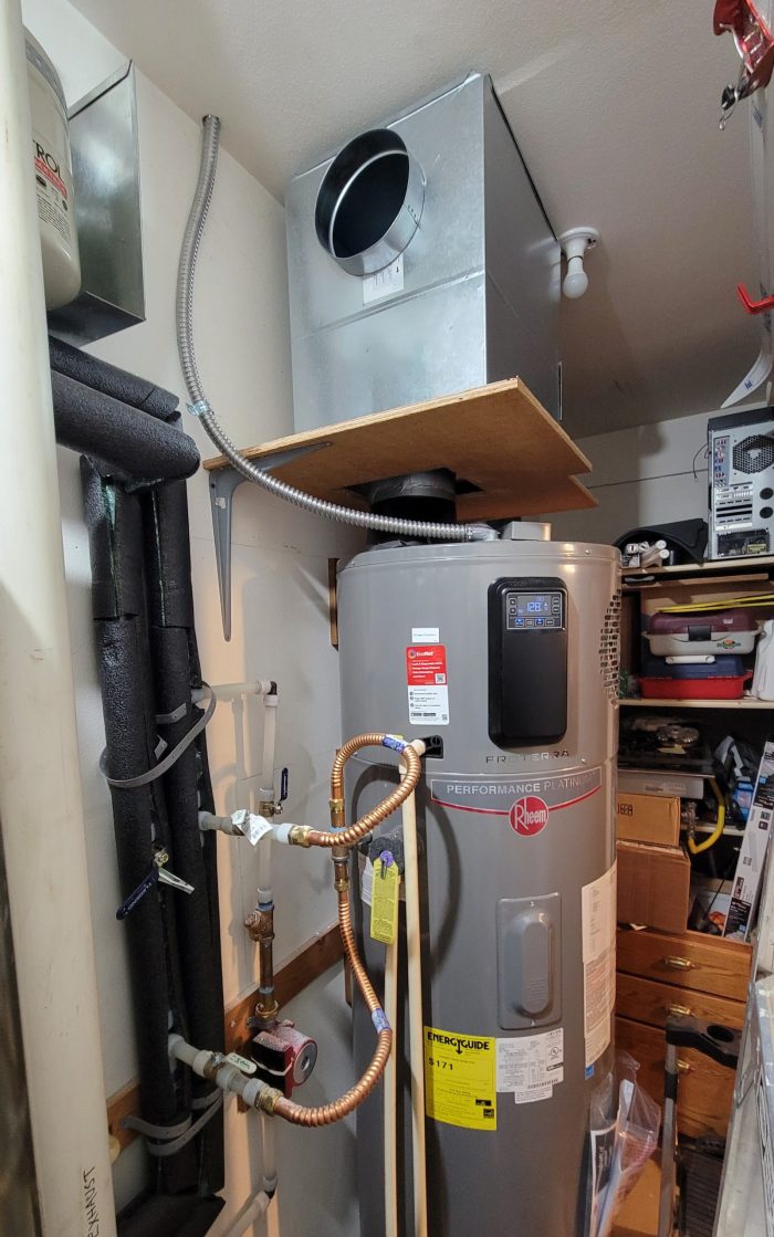

    Yes, I have a HPWH in my current and previous homes, and I had a local HVAC contractor build me a filter box for a 16x16x4 media. It also has the advantage of pulling in the air at the very top of the room where it is warmest.
    Also, in the newest install, shown, I am using the HPWH as a pre-heater for a gas-fired hydronic water-to-air heating system that is also for domestic hot water. Valves are installed that enable taking the gas system out of the circulation when the heating season is done.

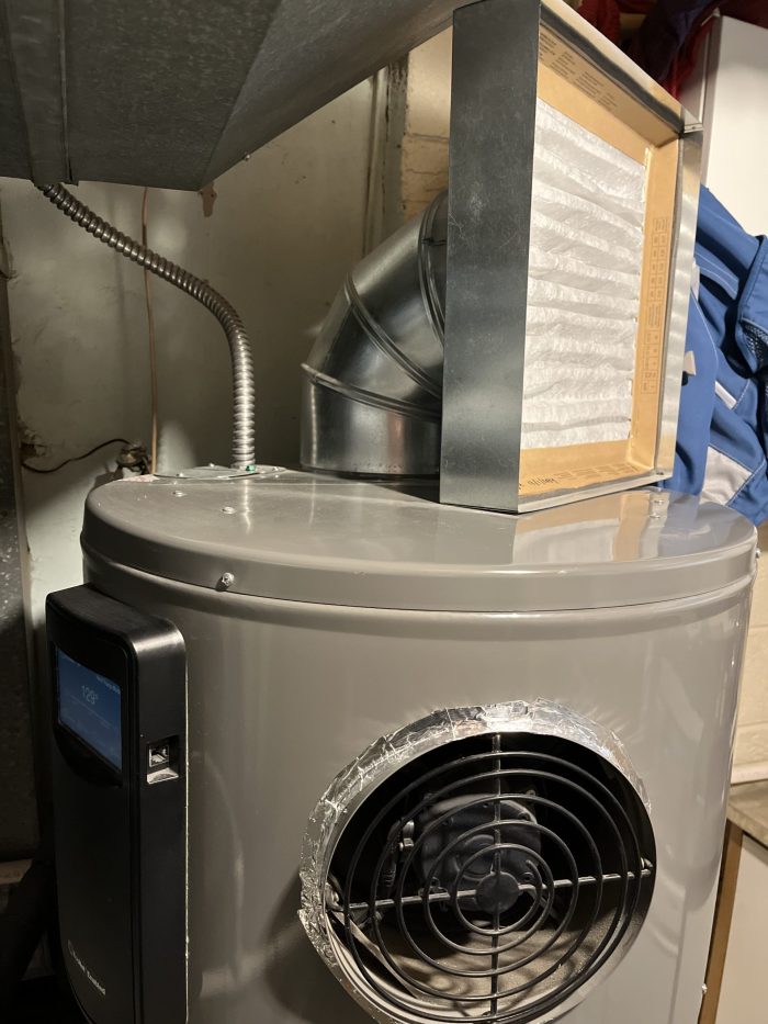

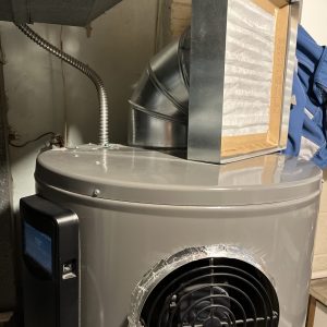

    Here is a pic of my setup on a gen 4 Rheem with a 12x12x1 merv 5 filter in a 2-3 inch deep box. Probably would be better with a bigger filter and a bigger and deeper filter box. Maybe also a higher merv filter. I also taped around the outlet because some air was being sucked in there.
