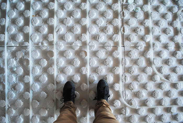

A dimpled pattern molded into the surface of these expanded polystyrene floor panels simplify the installation of PEX tubing for radiant floor heat. The insulation is 7 1/2 inches thick.

The under-slab insulation was then cut and laid. We elected to use 7 1/2 inches of insulation, which is likely overkill but it does bring the floor insulation to R-30. (Our last house had no insulation in the basement at all.) First, there’s a 5-inch thick layer of Nudura EPS, then a 2 1/2-inch thick layer of Hydrofoam, also made by Nudura. This EPS insulation was pretty cool. Having a honeycomb pattern as the top layer allowed for incredibly easy installation of the PEX piping for in-floor hydronic heating.

We still needed a heating system, and a concrete floor would accommodate in-floor tubing for hydronic heat.
