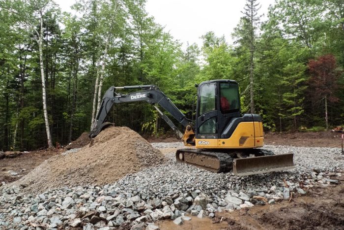

In August 2013, an excavation contractor spread a layer of crushed stone to prepare for our planned slab foundation. Our one-acre lot in the White Mountain region of New Hampshire was undeveloped when we purchased it in 2012.

Work started in early August on foundation prep. I visited the site on a very rainy morning to see lots of activity; trucks of crushed stone were arriving with a small excavator buzzing back and forth to prep for the slab. The heavy rain that morning was actually helpful because it showed some of the water patterns on site; an extra load of crushed stone was brought in to slightly elevate and provide more drainage under the slab.
Slab Prep 08-09-2013 from Brian Post.
The next layers that needed to be installed before the slab could be poured were a layer of rigid foam insulation and a vapor barrier. Before that could happen, though, we had to get the plumber and electrician on site to do their sub-slab work. This was scheduled to happen in mid August.
