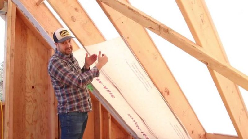

Josh Salinger, owner of Birdsmouth Design-Build, is on-site in Portland, Ore., to discuss the vaulted high-performance and foam-free roof assembly on their latest ADU build.
Vaulted roofs are a popular option because they create usable living space where an attic would usually be. Typically, plastic forms such as spray-foam insulation or rigid foam are used to deter condensation and moisture issues in a roof assembly.
In this video, Josh shares his plastic-free solution to manage moisture and allow for full-depth insulation with proper venting while creating a high-performance vaulted roof assembly.
Read more about all the details of this roof assembly in Josh’s article, “A New Take on Insulating a Roof.”

        The issue with using plywood sheathing and strips above (likely needed 2x's for ventilation) is if you are using plywood in lieu of a highly permeable membrane, it in effect becomes the primary vapor control layer (the least permeable part of the assembly) as the plywood has a perm rating of around 10 perms. The smart membrane below will vacillate between (roughly) .1 and 10. When the plywood becomes the primary vapor control layer, then this part of the assembly becomes the point of concern since its on the cold side of the assembly. It is essentially open to the universe as the vented area above is no different than the area above the roofing-- the same as just stuffing a rafter bay with fluffy insulation.
        If one is using a highly vapor open membrane such as Tyvek, which has a perm rating of 53 perms, the lower membrane on the warm side of the assembly becomes the vapor control layer. The lower membrane controls the vapor diffusion into the assembly and is warm so there is no condensation, the upper membrane is wide open so the vapor that gets in can escape through it into the vented area above (this depends on the season, RH, interior temps, etc., but the principle stands). The key to this detail is that the smart membrane is not just controlling the vapor, but also is the air barrier.
      Joshua Salinger | | #7
      One of the issues we were trying to solve with this roof system is how to vent roofs that aren't simple gables. The problem with the 'RafterCaps' or creating a vent chamber below the roof sheathing via baffles or a site made chase is what does one do if one has a valley, hip, dormer or other obstruction to either the bottom or the top of the rafter bay. By bringing the vent chamber over the top of the valleys, hips, etc. it completes the ventilation from the intake to the ridge. It also has the benefit of using this space for insulation instead of air.
      I have gotten the Q about the bowing many times and I don't have an empirical answer to it. I assume it is bowing, especially at 24" OC and a good dense pack install. That being said, I also know that cellulose settles over time and whatever bowing there is will likely be reduced, but as to how much is anyone's guess. It probably has a lot to do with the quality of the install. In a strange twist, a poorly installed cellulose job would likely reduce the bowing issue.
      The only way to really find out would be to peel off the roof after insulation. Unfortunately, I have yet to find a client who is willing to have us rip off the roof of their new home to check on the insulation install...
