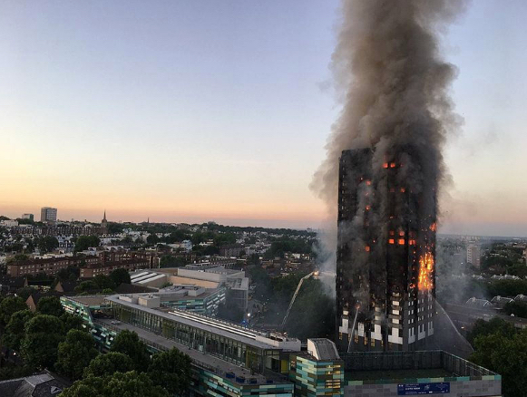

Botched details in a two-year refurbishment of a London high-rise turned what had been a safe concrete tower into a “tinderbox” that contributed to the deaths of 72 tenants, a British newspaper reports.
The Evening Standard said it had obtained a report from investigators at BRE Global. The report blamed the disaster not only on the combustible materials that were used to reclad the building’s exterior but also on poorly executed building details.
The fire reportedly began in a refrigerator-freezer in an apartment on the fourth floor. Flames might have been contained to a single apartment, but instead traveled through a window near the refrigerator and raced up the side of the 24-story building. Were it not for the replacement cladding — an aluminum-clad material with a polyethylene core called Reynobond — not a single life would have been lost, the newspaper said.
The cladding was added to the tower during a two-year retrofit completed in 2016.
Multiple problems to blame
In addition to using combustible cladding, builders also failed to meet fire-safety standards in several ways, according to the report:
  • Barriers within wall cavities that should have prevented the vertical travel of flames were of “insufficient size specification” and some of the cavity barriers were installed incorrectly. The result was a chimney-like path allowing flames to spread.
  • Window frames didn’t completely fill the gap between concrete columns, and none of the materials used to fill out those spaces was able to provide 30 minutes of fire resistance. This building detail provided a “direct route for fire spread around the window frame into the cavity of the facade … and from the facade back into flats,” the report says.
  • Contrary to building regulations, many apartment front doors lacked automatic closing mechanisms. When residents fled their apartments, doors remained open, allowing “large quantities of smoke and later fire” to pour into areas near the doors an then into elevators and the single stairwell.
Another problem was the lack of a “wet rising main” — a fully charged water main rising through the tower that would have provided water for firefighting. When the building was remodeled, an existing dry main was extended and modified. The main, however, had to be powered by a single fire engine on the east side of the building because landscaping on other sides of the tower made them inaccessible to firefighting equipment. A single fire engine didn’t have the power to provide enough pressure and water flow for firefighters at the top of the tower.
The building also lacked a sprinkler system.
