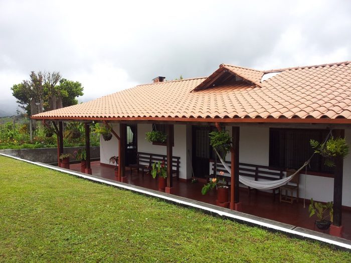

Concrete block construction is commonplace in tropical regions. What effect do the high-mass exterior walls have on interior conditions? Photo courtesy BY-YOUR / CC BY 2.0 / Flickr.
AlbertoArriaga33 is wrestling with plans for a new home in a tropical location. He doesn’t say exactly where, but conditions are certainly challenging: high heat and high humidity, with nighttime temperatures dipping only into the upper 70s and outdoor relative humidity hovering at about 70%.
Exterior walls will be grouted concrete block, what Alberto says is standard construction in the tropics. Outside walls will be finished with a cementitious plaster and then painted. On the inside, light steel framing and stud cavities filled with R-15 mineral wool batts.
“However,” Alberto writes in this Q&A post, “I have many doubts and still not sure if I quite understand how thermal mass works. I’ve read that typically you would want to keep the thermal mass inside in a hot climate in order to keep it from absorbing solar energy, and subsequently heating up your house at night.”
Alberto wonders how the mass of the concrete-block walls will affect interior conditions, and whether the interior insulation will be enough.
“My guess is it would slow down the transfer of thermal energy from the walls to the interior space as it radiates throughout the night. Is the thermal performance of the assembly affected substantially by whether the insulation is on the exterior or interior?”

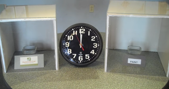

    I'd like to see more data on practical applications of "moisture buffering". For example, would clay plaster provide a significant comfort improvement in the common case where the AC has good latent removal during the day (when loads are high) and poor latent removal at night (because loads are low or even zero). Supplying dehumidification to every closed-door room can be a design challenge and is often not done.
