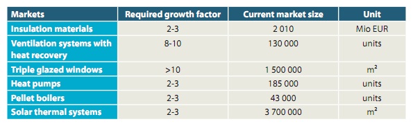

Products for nZEB projects. As shown here, heat-recovery ventilation systems and triple-glazed windows are expected to see the most growth among the six building-product categories listed, should buildings in the EU reach their carbon-reduction targets by 2050.
