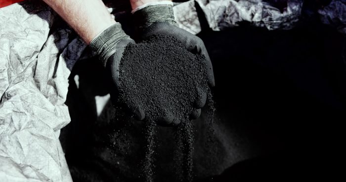

The average clump of biochar is practically indistinguishable from something you might find in a bag of Kingsford charcoal briquettes. And the truth is, their ingredients aren’t all that different. Most biochar is composed of forest or agricultural waste, or biomass, that has been thermally decomposed via pyrolysis, the process of cooking the material in a low-oxygen environment and binding its embodied carbon to the charred yield.
