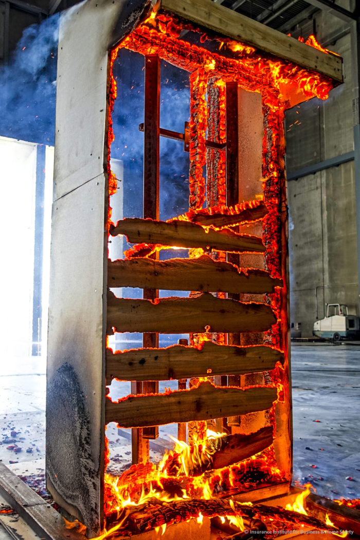

This owner-builder wants walls with a high R-value that address the region’s high risk of fire
Wildfire testing: A test wall undergoes a destructive test at the Insurance Institute for Business & Home Safety Research Center. The organization is a good source of information for builders working in areas prone to wildfires.
Image Credit: IBHS
Will Welch has chosen to build his high-performance house in Nederland, Colorado. The site is at the border of Climate Zones 6 and 7, and it poses some challenges: it’s at an elevation of 8,600 feet; the area gets a generous amount of snow and wind; and the number of heating degree days tops 8,800 a year.
But Welch has one more concern: the threat of wildfires.
“My priorities are a tight building envelope with high-R walls and more environmentally friendly materials that also resist fire, but I’m also trying to get the most bang for the buck on those materials,” Welch writes in a post at the Q&A forum.
His plans currently call for a 2×6 framed wall rather than a double-stud wall, mainly as a way of preserving all the interior space he can. Wall cavities would be insulated with dense-packed cellulose or a mixture of closed-cell spray foam and cellulose, with 5/8-inch drywall on the inside and 5/8-inch plywood sheathing on the outside. On the exterior, Welch would use 4 inches of mineral wool insulation, covered with a mix of corrugated metal and fiber-cement siding.
“I’m leaning away from rigid foams for the exterior insulation because a number of them either don’t perform well in fires or in the cold, have thermal drift over 5-10 years, or are rough on the environment,” Welch says. “That said, exterior mineral wool doesn’t look nearly as cost-effective as something like recycled rigid foam.”

    Is it really possible to ignite furring strips?
    John Straube was here (Sonoma County, CA) a couple weeks ago presenting on continuous insulation and someone asked him if furring strips could catch fire. He said "no, a 3/4" furring strip just doesn't have room to catch." He went on to say maybe if the gap was a couple inches, maybe. It was an important answer to me since I have remodeled my entire house with continuous foil-faced poly-iso, 3/4" thick furring strips, and HardiPlank siding. The thought that I had inadvertently introduced an ignition source was disconcerting, so I was glad to have John confirm my thought. But it would be nice to hear another expert poke a hole, or possibly confirm, this fear.

    In the document that John Clark provided a link to, Joe Lstiburek wrote:
    "The fire implications of too large of an air gap behind a cladding are huge. Air flowing behind a cladding can feed a fire in the cladding or feed a fire in the insulation behind the cladding. Both happened in spades in the Grenfell Tower. The buoyancy of fire heated air flowing upwards in the air gap behind the cladding acted like a blow torch or a bellows feeding the fire. When the air gap is small…less than ¾ inch…the friction from both surfaces bounding the air gap limits the air flow. The boundary layer on both surfaces is an effective fire stop."
