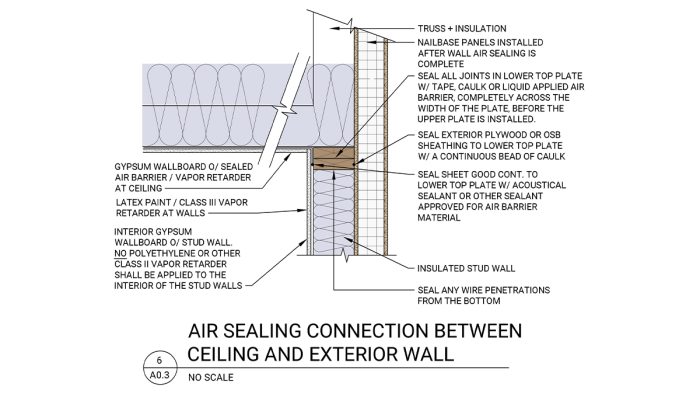

When I began working with my first set of construction drawings for a net-zero-energy home in 2020, the third page of my drawing set contained something I had never seen before in my design work: a drawing sheet specifically devoted to air-sealing details. The design and construction industry is slowly coming up to speed about the role the air barrier plays in comfort, durability, and energy efficiency. Still, designing and building a continuous air barrier is the exception and not the rule. Devoting a drawing sheet to thorough and clear air-sealing details is just one of the strategies we employ to set the builder up for success in high-performance building. In this article I’ll take you through the designer and draftsperson’s perspective on some of the critical details we include on this sheet. If you’re looking for higher-level information on the air barrier, check out these articles:
Design the air barrier and include it in your plans
If you’ve spent time researching air-barrier strategies, you’ve likely heard about the redline (or red pen) test. If you haven’t, it’s this: On each building section in a drawing set, use a red pencil or pen to trace the entire air-barrier assembly. If you have to “stop the line,” or pick up your pencil, the design may not have planned for full continuity of the air barrier. The air-sealing sheet we include on our drawings is essentially an extension of the redline test, allowing us—and the builder—to plan for the connection points in greater detail, all in one place. We include a short narrative section on our air-sealing details sheet that emphasizes the importance of a…

    One small thing I do slightly differently. At interior partitions I staple the strip of poly to the top of lower top-plate, then sandwich it between it and the upper one. This does a few things:
    - It means the interior walls are walk-able when installing the trusses
    - The poly is protected by the upper-plate while the rest of the framing occurs.
    - The poly is folded up onto the side of the upper-plate and the poly on the ceiling gets folded down, so there is solid backing for both, making them less likely to separate.
    - Holes for electrical and plumbing are less likely to tear the poly, and easier to seal.
