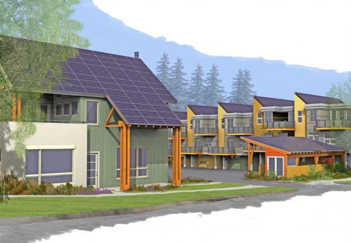

Boulder architect George Watt is currently designing a near-zero-energy house that will be built at The Ridge at Chukker Creek, a green residential development near Aiken, South Carolina. Watt also designed Spring Leaf, a 12-unit near-zero-energy project in Boulder, Colorado, shown above.
Image Credit: George Watt, architect

Architect George Watt of Boulder, Colorado, is finalizing plans for the home. “The approach is to do it as an all-electric house,” said Watt. “We plan to use an air-to-air heat pump with a COP of 3.6 or 3.7 and an on-demand electric water heater. The house will include an induction cooktop and Energy Star appliances to keep loads down, along with a Lifebreath HRV. It will have a terrific building envelope, well insulated and well sealed, with R-20 walls and an R-40 roof. I expect that the house will need a PV system sized between 8 and 10 kilowatts.”

  1. homedesign | | #1
    nice pv
    I like this image...the solar panels are integrated into the architecture..and it has an overhang!
    Nice work George Watt.
    The roof fits the modules
    John,
    George told me that he prefers to use conventional rack-mounted PV modules rather than roof-integrated PV tiles or slates, because the power output per square foot of conventional modules is greater. However, he always sizes his PV roofs carefully so that the roof dimensions are multiples of the PV module he intends to use. That way (with proper rake, ridge, and eave detailing) the modules appear to be roof-integrated.
