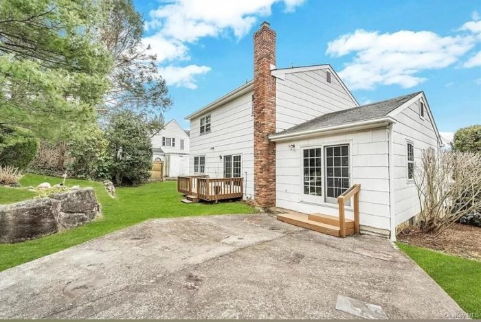

Houses are a needy bunch. As a certain character from that late-night weekend show used to say, “It’s always something!” And particularly with older homes, “always something” can actually mean that there’s really a lot to do all at once. This seems to be the situation “Squishy” is in with his 50-year-old home in Climate Zone 5A. In a recent Q&A post, Squishy said he wants to improve his house’s energy efficiency and durability while reroofing—upgrading insulation, siding, and windows, and potentially bringing the attic into the conditioned enclosure. He’s completed some projects, such as upgrading the insulation with mineral wool—R-15 cavity insulation in the walls and R-30 in the attic floor—and transitioning from baseboard heat and no air-conditioning to heat pumps on the first floor.
Now he wants to start on the exterior.
The house needs a new roof. Is this the time to extend overhangs so he can add continuous exterior insulation and new siding to the walls? Should he insulate the roofline and bring the attic into conditioned space? There is an air handler in his attic. The siding needs to be replaced, and he wants to use fiber cement, but the existing siding is asbestos. Does he need to remove and abate it, or can it be covered with insulation or maybe Zip-R insulating sheathing? The windows are single-glazed and need to be upgraded. Where do they fall in the list of priorities? Finally, Squishy hopes to add solar panels to the roof. Is that the last thing he should do?
“The increased thickness [of walls with exterior insulation and a second layer of siding] makes me want to extend my roof overhang as much as possible,” Squishy wrote, “but I don’t know what is possible without…
