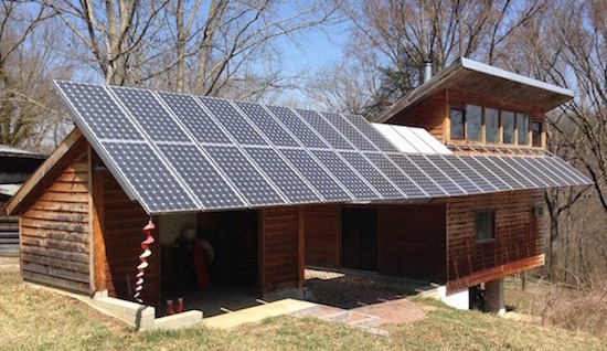

Rooftop photovoltaic arrays provide clean electricity, and the cost of solar is plummeting.
