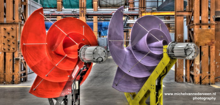

A new wind turbine from Holland. The photo shows two of the Liam F1 wind turbines developed by The Archimedes, a research company and manufacturer headquartered in Rotterdam.
Image Credit: The Archimedes
A Dutch company says it has developed a new type of residential wind turbine that is far quieter and more efficient than conventional designs.
The Liam F1 is a horizontal-axis turbine that uses a revolving collector in the shape of a nautilus seashell, rather than blades, to spin a generator.

    The rated power of het beestje = 1.5kw max, 1.0kw nominal
    Look like they married the turbine to a 1.5kw generator sized optimize it's output at lower than gale-force winds while discarding any excess power beyond that when it's really howling:
    http://dearchimedes.com/pdf/Folder_Liam_molen_2014.pdf
    The key distinction from other turbine types is it's low cut-in speed (2m/sec, or about 4.5mph) and relative efficiency at low to mid wind speeds, and it's insensitivity to turbulence, which allows it to deliver at least some reasonable output when mounted on buildings (or even ground mounted).
    Like any small wind turbine it's still pretty much a "roof ornament" unless you live in a location with the wind resources. In the flat swamplands of NL, being downwind of the North Sea means you can pretty much count on average wind speeds over 2m/s anywhere in the country (and in most of the coastal areas MUCH higher than 2m/s). Looking at the power output plotted against wind speed it takes a fairly stiff 28mph to hit the nominal 1kw output, and at 13mph it's only delivering about 100 watts. If your local wind-speed near the ground averages ~10mph over the 8760 hours in a year you might get 1000 kwh /year out of it but if it averages over 15mph (which it might in some coastal or hilltop locations) you could be north of 2000kwh/annum.
    The energymatters.com's estimate 1180-1500kwh/annum is lifted directly from that spec sheet (with some rounding errors- 5.2m/s is 11.632 mph- they should have rounded up to 12mph, or called it ~11.5mph.).
    Noise-wise it looks to be about 50-60 dbA, which is hardly above the sound wind against your window, comparable to some home refrigerators.
