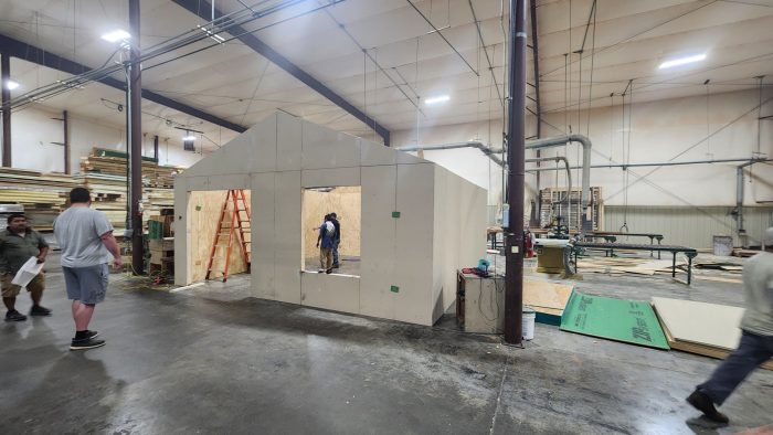

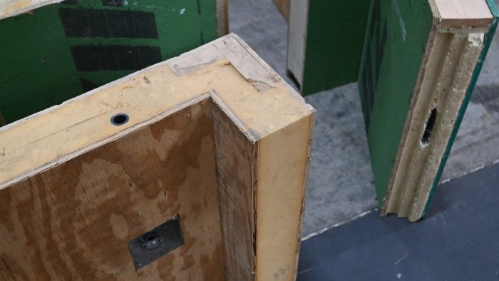

The Eco-Panels facility operates on a modest scale, resembling a high-end cabinet shop more than a large manufacturing plant. During the visit, Leahy highlighted key distinctions between Eco-Panels and traditional SIPs:

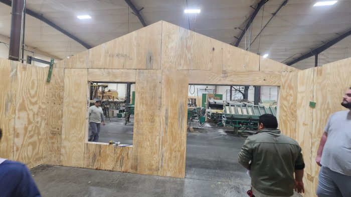

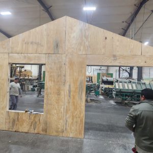

    Hello Fernando - this is Charles Leahy, president of Eco-Panels. First off, I would like to thank you for your business! I was however surprised to see your article without notice to us and your revealing bits of information - including potential quality issues - that you had not shared with our company as the building was being assembled - but I understand the whole social media thing and a desire to create a story. As you may recall, our team had been significantly interested in being involved with your panel set in the Houston area because you had mentioned you might be documenting it, yet our attempts to reach out and be involved and see photos were rebuffed by you. If the panels had not been left out in the Houston weather for a month or two prior to assembly you might have had a better experience. We never heard from you that the panels fit tight over the base plate - this can happen for at least three different reasons. First, when we fabricate the panels we are using untreated 2x4 lumber to create the "void" at the bottom of our 4.5" thick wall panels - and when we are typically shipping panels to a jobsite that has only JUST attached their base plate to the floor platform just prior to panel arrival, there is no "tightness of fit" issue like your team experienced. If however the foundation with plates was "ready" almost two months before the panels were set, then those plates would have swollen from weather. This absolutely will happen and could have been the cause. While we had asked you for photos of the jobsite prior to our delivery of panels - and even after the delivery of panels - we did not receive them - so who knows? Second - if your team used a pressure treated piece of lumber as the base plate - that is always swollen compared to untreated 2x lumber - then that would have been a reason for the tightness and absolutely it would have been needed to be trimmed - we even talk about this in our Assembly Manual which we had sent you prior to assembly. Again photos might show evidence of what happened. Third possible reason - the fact that the plywood skins of our panels sat out in humid Houston area weather for well over one month and possibly close to two months virtually guarantees that the plywood interior skin that you had requested (and is NOT typical of the panels we shipped) swelled at the edges - including the bottom of the panel - and this would cause an inconveniently tight fit. Note our Assembly Manual and other documents SPECIFICALLY ADVISE to NOT receive panels before they are ready to be used because we know things like the swelling of plywood - or swelling of untreated base plates - or damage on a jobsite - can happen. I do wish this had gone more according to our recommended and normal course of business - I think better cooperation and communication with your team would have prevented those issues being a concern. Regarding the 1.5" gap - where did that occur? As we shared photos of the structure set up in our factory prior to shipment, we saw no large gap (some of those photos are attached). As with every structure - we assemble it and check dimensions prior to it shipping out the door - we would have seen a gap that large and it would not have passed our quality check. Of course if dimensions are not accurate on a jobsite (and they rarely are), then that is a darn good reason for the gap - but our panel system does have a way of dealing with that. I assume that they were able to work through it. I am glad that you seem to have liked the electrical layout - at least you did not complain about it - as you know you pretty much left it up to us to figure out the details after you gave us a high level specification.
    Regarding the siding chosen - we love the LP Smartside Product - but as their installation guidelines show, gaps are most commonly covered by their trim - that is by design of their product. Regarding the AC plywood - I do remembering cautioning your team about undo expectations even before we build panels - but it seems you have forgotten that conversation. 99% of our clients do not even try to achieve a finished interior skin when they order our wall panels - we like it that way because we are better able to meet client expectations which we already try to take very seriously. And while you mention "drywall" as a siding in your article - that is definitely NOT a siding that we offer - though we do love the Huber ZIP System sheathing that you mention - it is our most popular exterior siding option by far.

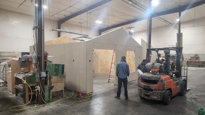

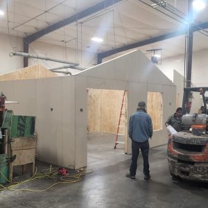

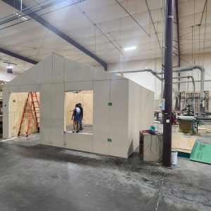

    As already mentioned I have provided in this response photos of the panels assembled in our factory for a quality check of your pump house that we took prior to shipping the panels to you in Houston in December. I think your unit was actually assembled by your team some time in February - two months later. I can appreciate your team's assembly of our panels because the finished product in your photo looks great! They are clearly a good team and do good work and can clearly overcome obstacles without reaching out to the manufacturer (though our extreme preference is that if people are having any problems they reach out to us and COMMUNICATE). Please note that our Assembly Manual - even the one written in Spanish that we sent you - does advise to reach out to us if someone is having any issues.
    And we have documented 50 and even 60 degree temperature differences from passively cooled structures (see video proof in our website video gallery) when viewing outside surface temps and interior temps of structures made with our panels. I have never observed this degree of behavior (20 deg is typical) of stud framed structures and I look forward to your collecting data this summer in the Houston area. We know in some parts of the country the crews work until around noon in the summer and then it is too hot in the house under construction and they go home (they do start very early) - this would not be the case when using our panels (and has been proven).
    As a former (award winning) writer myself I would suggest that when writing a story context matters. When you don't share additional critical details - such as the panels weathering prior to assembly, such as lack of investigation of that base plate, such as the fact that the configuration of panels that you chose - and were cautioned by us regarding their final assembled finish - and that happened to be some kind of impression-forming experience that is then somehow relatable to the average reader that would not even be using that siding - I think that warrants an air of further clarification on your side AT THE START of the article. We work with amazing clients every year that are building their own homes complete for between $100 and $150/sqft (and of course others building homes for more expensive than that) and we could not be more proud of that. To try and cast doubt about our product without sufficient and critical context and call into question our quality when you provided us a very difficult working experience I believe is not fair.

      Charls, I wrote to you about the discrepancies, and I do not believe that some time in the weather would have shrunk the panels two inches or created a 3-inch misalignment between stacked panels. Nonetheless, I believe you read with too much sensitivity, especially for a writer. My book was just reviewed in JLC. I appreciate the review very much, but not all of it was positive. If I made a factual error, I will gladly correct it. But the issues were created at the factory, not on-site. I do not dislike Eco-Panel; it's a brilliant product that would benefit from improved manufacturing tolerances. I was very complimentary of the energy performance.

    The sill plate issues are common to all SIPS. Typical polystyrene SIPS can be more easily forced on top of swollen sills. Maybe due to lesser grades OSB but also because the bond to insulation is not as strong as with Eco-panels. I have never experienced delamination with Eco-panels unlike with polystyrene panels. We always pre-rip our sills 1/8” if pressure treated and may take some off kiln dried lumber if expected to get wet before panel erection. This issue is made clear in their assembly manual.
    We have never attempted an interior finish integrated into our SIPS and I’m sure the issues of doing so were made clear. No SIP company appreciates panels sitting outside of conditioned space for long periods before installation. This is especially true for wet and humid climates.
    Exterior finish should not be taken lightly and requires extreme attention of detail to properly weatherize.
    The cam locks are nice but it’s never bothered us when one doesn’t seem to work. They are more of an assembly assistance than necessity. Shimming out fascias is another thing common to all SIPs. Run a string and fill it in.

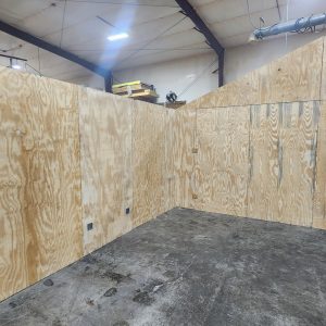

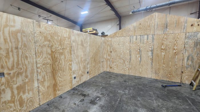

      Our program was explicit: we wanted to explore whether the factory-applied plywood interior could serve as the finished wall. That’s where the misalignments became a real issue. We dealt with the exterior issues using wide battens. Inside, that wasn’t an option.
      I agree that all SIPs require care at the sill. But some systems—especially CNC-cut ones—don’t show the same degree of dimensional variation. Eco-panels aren’t made in a shop environment, and it shows. That’s not a dealbreaker, but it’s something to factor in.
