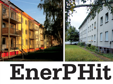

Since it is much trickier to hit the Passive House standard for a retrofit project than for a new house, the Passivhaus Institut has created a retrofit standard that is ambitious but achievable
The Passivhaus Institut in Darmstadt, Germany calls its new retrofit standard EnerPhit.

The Passive House Institute has been working on a way of dealing with this elephant for the past number of years. Finally, at last year’s Passive House Conference, founder of the institute, Dr. Wolfgang Feist, launched EnerPHit, a passive house certificate for the modernization of old buildings.

Speaking at the launch, Dr Feist pointed out that the energy consumption of old buildings can’t usually be brought to the level of new build passive house standard, because among other things, some unavoidable thermal bridges remain. “But the same components as for new passive house buildings can be used, and the building substance can thus be protected and sustainability can be improved significantly. In numerous projects, a reduction of 90% in the heating demand could be achieved.” As Feist implies, the institute recognizes the multiplicity of building forms faced by retrofitters and as a result has stitched a significant level of flexibility into the EnerPHit standard. The thresholds are looser, and nor are there as many of them. Moreover, a form of certification is achievable even if these minimum values are not.
“EnerPHit reflects the fact that when you’re retrofitting, the challenges are much greater,” says Tomás O’Leary. “With new build passive house, the space heat demand is 15 kw/m2/yr. It’s 25 kw/m2/yr for EnerPHit.” The other key parameter is airtightness. The 0.6 air changes per hour required by passive new build is retained as a target only, with a rate of under one deemed satisfactory for refurbishment.
