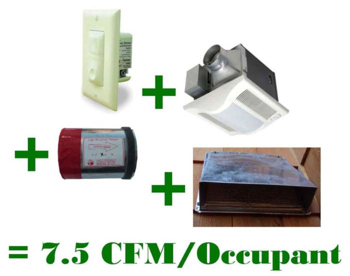

One builder’s approach to providing 7.5 CFM of fresh air per occupant
Choose the right products. An occupancy sensor / timer + an Energy Star 110-cfm bath fan + a back-draft damper + an exterior filter holder = a system that provides 7.5 cfm per occupant.
View Gallery 5 images
Choose the right products. An occupancy sensor / timer + an Energy Star 110-cfm bath fan + a back-draft damper + an exterior filter holder = a system that provides 7.5 cfm per occupant. In-wall motion sensors make adjusting the timer easy.
Image Credit: Watt Stopper Legrand
The Panasonic bath fans are quiet and durable and worth the extra cash. if your customer is likely to turn it off and leave it off you can buy the model with a built-in occupancy sensor and adjustable timer and hide the switch in the closet.
Image Credit: Panasonic inc.
Ultra silent and sensitive Cape back-flow dampers can be installed in the wall behind the dryer or fridge so the incoming air blows on the steel frame of the appliance. That way the air isn't as likely to be perceived as a draft by the homeowner.
Image Credit: Tamarack Technologies inc.
A six inch or larger exhaust vent hood can be adapted: by removing the damper and replacing it with a washable range-hood filter, we minimize pollen and keep out bugs and mice.
Image Credit: Michael Chandler
After trying a variety of ventilation approaches, I’ve settled on exhaust-only ventilation systems with ventilation rates that are on the low side of most recommendations.

My solution has been to use a simple and inexpensive form of exhaust-only ventilation controlled by very robust and attractive Lutron MS-OPS5AM or the slightly less attractive Watt Stopper RS-250 occupancy sensors with adjustable timers. These controls give me the fresh air I need when people are in the home but automatically scale back when the people are gone.
Do the math first
To provide 7.5 cfm per occupant, we need to provide 7.5 x 60 = 450 cubic feet per occupant per hour. That can be provided by a 110-cfm bath fan (hood tested at 80 cfm actual) for 5.6 minutes. If the average individual spends 12 hours per day at home and 12 hours away from home, we need to run that bath fan 5.6 minutes times 12 hours — or 67.5 minutes per day — to provide adequate fresh air for that occupant.
If some of the occupants are teenagers or adult children who only occupy the home intermittently, there should be a mechanism by which the house can dynamically respond to variations in occupancy levels. Time-delay occupancy sensors (used as bath fan switches) allow the home to respond to varying occupancies without conscious input from the homeowners.
We set the master bath fan at a 30-minute time delay. This is based on the assumption that it will get triggered on average four times a day by two occupants.
We put the kids’ bath fan on a 15-minute delay and the powder room on a 15-minute delay. If the kids are away at school, there will be no additional ventilation (since their bath will not see any use), but during a family reunion the venting will be stepped up automatically.
We use Energy Star rated 110-cfm Panasonic bath fans, but any Energy Star rated bath fan will do. Our flow-hood testing has shown that a 110-cfm fan actually removes about 80 cfm, so that is what we design for. It is essential to have your Energy Star certifier or HVAC contractor verify the output of the fan to confirm the efficacy of your timer calculations. You may also want to adjust the timer settings upwards if the homeowners have a lot of houseplants or pets.

Sources of supply:
R.E.Williams Industrial Supply
Panasonic fan/light, $149
Cape back-draft damper, $21.50
Lutron MS-OPS5AM occupancy sensor, $32
Watt stopper RS-250, $32 (not as attractive as the Lutron)
We’ve had an unacceptable failure rate with the Cooper 6109 occupancy sensors sold in the big box stores, and we now avoid them.
