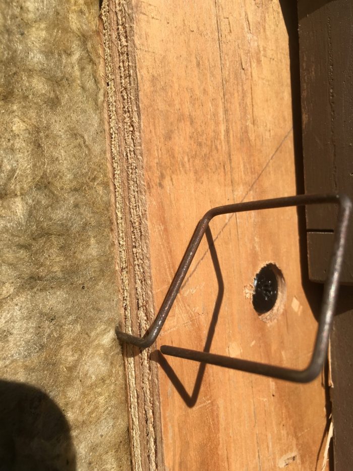

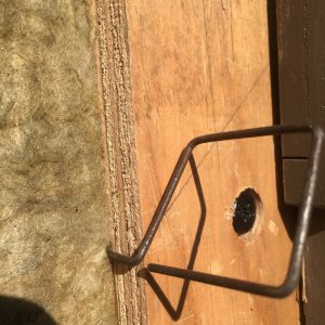

    I also use a depth gauge made of bent insulation wire. I make it 2.5" for 2" MW with 1x3 strapping to compress the MW a little. Over compress then unscrew until the strap hits the gauge. However, if the wall is wonky, and old walls typically are, this is just a starting point with adjustments required after.
    I know anecdotes don't meet code but the BSC studies are legit and I have seen no movement myself.

    With regard to fastener length-MW compresses a little so i have chosen to choose to compress it by 1/4” with the strapping. Then i recess the heads of screws about 1/8” into strapping. The math out to in is 5/8” plus 2 3/4” plus 1/2” plus 1-1 1/2” penetration into studs. So ideally 5” screws. I’ve used Fastenmaster Headlok screws, though there are other brands with a washer type head and some may not make that length. You can get regular 5” construction screws but the small heads overdrive too easily in my opinion. I am thankful to hear in this article that 1” framing penetration is enough. I have been worried about poking a wire and the gambling it has been. I bought a Bosch stud finder with electrical sensing technology to mark an upcoming project like this.
