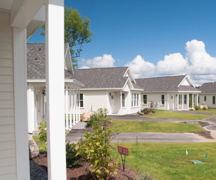

This is the first of six planned "pods" of houses at a development in Bridgton, Maine. Developers broke ground in April and have sold two of the houses to date. Two others are reserved.

Judging by the constant stream of visitors to their fledgling housing development in Bridgton, Maine, developers Justin McIver and Mark Lopez think they’ve found just the right mix of energy efficiency, price, and amenities for older buyers.
Yet the first thing prospective buyers are likely to notice about these houses is their size. Unless buyers are just moving out of a New York City studio, these places will probably have a lot less square footage than what they’re used to. Houses in the first “pod” of 10 units come in two sizes, 610 and 640 square feet.
Even so, Lopez would rather you didn’t confuse them with the 250-square-footers of the tiny house movement. They’re not tiny houses, Lopez says, “they’re tiny mansions.”
When fully built out, The Cottages at Willett Brook will consist of 60 units in six pods. Construction on the first group of houses, plus garage/storage units and a central clubhouse, started in April. Work is just starting on a second pod that will include homes of 900 square feet. The development is close to both a hospital and a supermarket and it’s in a popular lakes region about an hour northwest of Portland. It’s prime retirement country.
