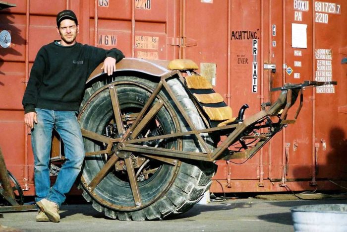

This photo of a one-wheeled tractor is from the early days of Energy Nerd columns. If a farmer can build a one-wheeled tractor, can a carpenter build energy efficient houses that don't rot? (Answer: Yes, we can)
