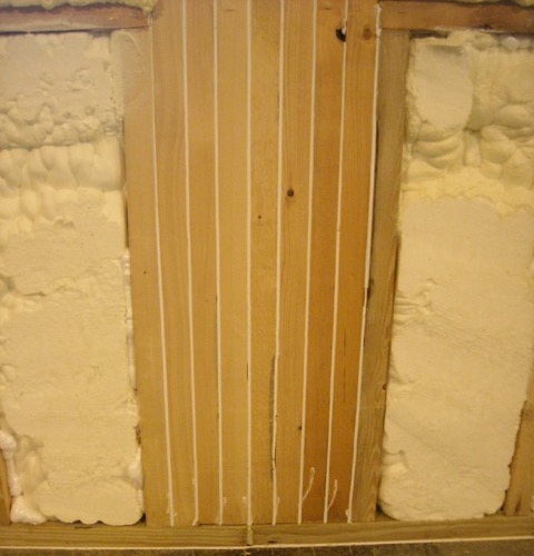

The thermal bridge of wood in this spray-foam-insulated wall lowers the R-value of the assembly.

Similarly, using only the insulation’s R-value ignores the effects of thermal bridging. Wood has a lower R-value than insulation, so including it reduces the overall R-value of a wall. And then, if you want to factor that thermal bridging in, how do you do it?

I got the center-of-cavity R-value by adding the R-values of the layers. I calculated a framing factor (ratio of framing to insulated cavity area) of about 13% using 9-foot ceilings to find the clear-wall R-value. I estimated a framing factor of about 30% to find the whole-wall R-value. (The difference between those two framing factors is that the clear wall framing factor includes only studs and plates whereas the whole wall framing factor includes studs, plates, corners, T-walls, and headers.)

The thing to remember here is that the R-value in your walls, floors, and ceilings isn’t the same as the R-value of the insulation you put in them. Oh, and one more thing: The R-value you calculate according to the definitions above isn’t a static number. It changes with temperature and other factors.
