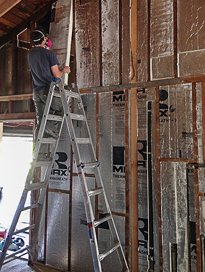

So… we needed a lot of foam. Over 100 sheets, actually. This type of insulation is called rigid foam insulation. The technical name of the material is polyisocyanurate, or polyiso for short. There are other kinds of insulation that are more commonly used — such as fiberglass and cellulose — but rigid foam is much more effective (and, uh, expensive).
After we removed the drywall, the walls were just a lot of empty bays. Chris’s goal was to fill each bay with a 3-inch layer of rigid foam.
The upside to rigid foam is that it’s one of the best insulators available. The downside is that, well, it’s rigid. While cellulose or fiberglass insulation is squishy and easy to stuff into different shaped spaces, rigid foam doesn’t have that flexibility. It has to be cut to fit.
Which meant Chris had to carefully measure the dimensions of every bay (which were all just very slightly different), and cut a custom piece of rigid foam into the exact size and shape of each one. [Editor’s note: This insulation method is called the “cut-and-cobble” approach. For more information on this technique, see “Cut-and-Cobble Insulation.”]
Chris used a table saw to cut each 4-by-8-foot sheet into smaller pieces (see Image #4 below). He wore a respirator because cutting the foam filled the air with a cloud of fine polyiso dust. It’s kind of like snow, except it never melts and will probably make you sick if you breathe too much into your lungs.
After using the table saw, Chris manually cut the foam to precisely fit each bay (see Image #5 below). For this he used either a circular saw or a Japanese Kataba saw. Then he would install each cut piece into its corresponding bay by gently pounding it in place with a mini sledgehammer and a block of wood.
Because we vaulted our ceiling, often Chris had to make diagonal cuts at exact angles, which was a pain to get just right. It was a slow, painstaking process. Chris completed five to 10 stud bays each day. Slowly but surely, the walls started filling up with shiny foil-faced foam.
Chris finally finished all the bays: woohoo! But wait — there’s more. Time to air seal. I didn’t know this before, but Chris explained to me that air sealing is a critical, often overlooked step when insulating a building. Without air sealing, you just end up with a foam box full of holes and cracks. So Chris used caulk or canned spray foam to seal every seam around each bay (see Image #6 below) Tedious, but important!
