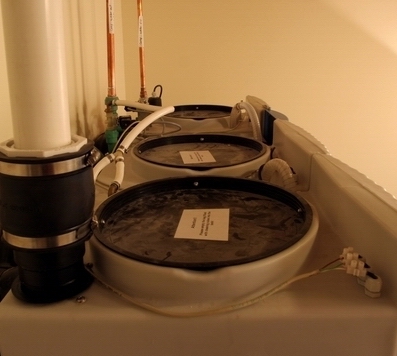

**Gray water can be high-tech** This three tank system aerates the water to promote beneficial organisms which can cut down on unhealthy pathogens. Gray water comes in through the large drain pipe and goes out through the small diameter pipes.

Imagine using some of the water that would otherwise go down the drain a second time. This is called gray water— domestic wastewater that has been used at least once and is effectively recycled for additional use. It may not be potable, but it can serve to flush toilets or irrigate the yard. Gray water is traditionally drawn from lavatories, bathtubs, showers, laundry trays, or clothes washer that have lighter impurities, such as soap or skin residue. It serves the toilet’s needs, and at no additional cost! Use of gray water as illustrated at right would be diverted to a tank and either fed to landscaping or retained until needed for flushing.
But, you may ask, is it approved? Appendix O of the IRC sets out prescriptive standards for gray water systems. There are even schematic illustrations that provide the novice with sufficient detail to install one. Appendix O may serve as an option for you to install in lieu of traditional sewer routing and for landscaping. These provisions are optional for each jurisdiction to adopt or not. For it to be legally available to you it must be adopted as part of the building code. In any case, you could take advantage of this provision through the use of Section R104.11 of the IRC, “Alternative Materials and Methods of Construction.”
Materials for the system are the same as for drain, waste, and vent piping. They must be inspected in the same manner as well. Any connection between gray water systems and the potable water system must ensure adequate protection to avoid cross connection. The gray water must pass through a filter such as media, sand, or dichotomous earth filter. A full open valve must be installed downstream of the last fixture to allow for maintenance and repair of the system. The holding tank or reservoir must be durable, nonabsorbent, corrosion resistant, and gas-tight.
For inspection and maintenance purposes, access panels are required on the tank. The collection reservoir must have an overflow pipe at least as large as the influent pipe. The drain pipe must be the same size as the overflow pipe. The drain must be on the lowest point of the reservoir and indirectly connected to the sanitary drainage system. The reservoir must have a vent to allow proper drainage and to prevent syphonage. Where gray water is used for flushing toilets, a disinfectant such as chlorine, iodine or even ozone must be used.

    I don't disagree with any part of this post, but I would like to point out that the greywater system diagram shown (and in particular the use of a pump) is overcomplicated and really not appropriate for the residential scale. Direct drainage under gravity power is really your best option at that scale -- gravity is free, and it doesn't get jammed by hair.

    We didn't have the proper rights to use the illustration that Brent is referring to. In its place is a photo I took of a gray water system in a house in Omaha, NE.
    Sorry for the disconnect,
