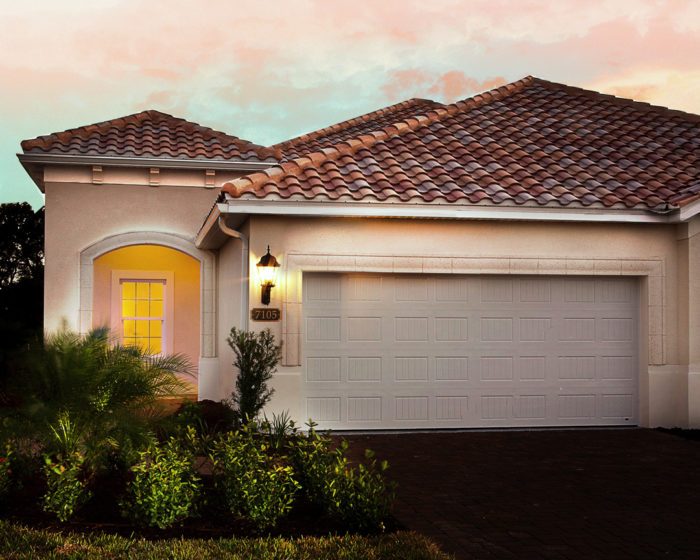

Here and there, production builders have taken a crack at green and high-performance homes. It's going to take a much broader effort than what we've seen so far to make an impact. Photo courtesy of Mirabella at Village Green, a spec home development of LEED platinum houses in Florida.
