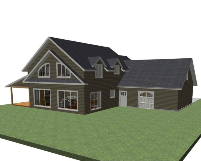

Bob Holodinsky is planning to build this house in Ontario but he's discouraged that the home's design heat loss is higher than he'd hoped for. Since this drawing was made, the area of the first-floor windows has shrunk by about 10%.
Bob Holodinsky was hoping for a better outcome from the heat loss calculations he received for his new Peterborough, Ontario, home — calculations that appear to have upset his plans for heating with a ductless minisplit. “I thought I was on the right track,” he writes in a Q&A post at GreenBuildingAdvisor, “but now I am not so sure.”
The 1 1/2-story, slab-on-grade house will be built with 2×6 exterior walls, insulated with blown-in fiberglass and 2 1/2 inches of expanded polystyrene insulation (EPS). Conditioned space totals about 1,900 square feet.
There are lots of triple-pane windows on the northeast side of the house, which faces a lake. The living-dining-kitchen area alone is responsible for a heat load of 17,000 Btu/hour, and the house as a whole shows a heat loss of 42,000 Btu/hour.
Holodinsky’s builder says that insulation in the roof will equal R-75. Exterior walls will have R-24 insulation between the studs, with an additional R-10 in the exterior foam sheathing. The slab is insulated with 3 inches of EPS.
“I was hoping to heat it with a Fujitsu minisplit on each level,” he writes. “Is that still a viable option?”

Although he can lower his energy demands by air-sealing and increasing the amount of insulation in the house, minisplits may not be the best fit for this Climate Zone 6 location, writes a GBA reader who calls himself Flitch Plate.
“I would be concerned with minisplits as the sole heat source in Peterborough, no matter what the BTUs are,” Plate says. “Heat pumps are the poorest performers and least efficient at the times you need them most: very low temperatures. I would design in a backup heating solution, such as a small…

    The north windows facing the lake might be the best architec. feature of the house,
    how much is it worth to you ??
    I'd say keep the windows and plan for exterior insulated shutters.
    And he will need backup heating,
    believe me, when it's -30c outside, the minis don't shoot anything else than warm air,
    so don't count on them to keep you warm during the night time, unless you double your planned insulation.
    Baseboards backup and a small efficient wood stove ( only if you have access to free wood or very cheap one ) will be required.
    with 25 to 40% of heat load due to air leaks as a "random" factor here,
    i'd plan for the worse.
    Put some $$$$$$ on air sealing , if it trully equates to 25%of heatload,
    it should be worth it to invest alot of money into it ( that is higher % than your window heat loss )

    As mentioned, I believe the orientation of the home is the biggest detriment. I know it's after the fact but for future vacant lot buyers, I would recommend that they always check on the orientation of the lot to the way the home will face for the views. If you want passive solar heating, always orientate the house facing south with your majority of glazing facing south. That way you get the best of both worlds; the views and free heat during winter. If you can't get that, I suggest finding a lot that does have these attributes.
    I'm not scolding you but on your design you have the majority of the glazing on the NorthEast elevation and that is the complete opposite of what a passive solar home would necessitate. "Free heat" via window glazing during winter would come from the south elevation. "Heat loss" through the windows will always be on the north, east and west sides of the home.
    Another thing to consider is that if you are facing a lake and your NE facing has all those windows, you will most likely get blasted by Zone6 winter winds coming off of the flat unobstructed surface of the lake and hitting that NE side. What is your Exposure Rating? Exposure "D" I assume? If so, that is important to take into consideration as these high winds can play a role in air infiltration and subsequent heat loss.
    I believe you can still do the ductless mini's. Mitsubishi has heat pumps that go down to -20F below zero. I would also recommend that you do NOT get an open wood stove for supplemental heat. You will FAIL the blower door test as that fireplace will leak like a hole in your wall or roof, because that is what it basically is. Get an electric resistance fireplace for supplemental heat. No cutting holes and venting to worry about. Plus the newer ones look very realistic and can put out around 3k-6k BTU's.

    Hello everyone..lots of advice to consider. First of all I have reduced the bottom front windows by about 10%...the outside foam will R20....this gets me below 30,000 btu heat loss ...the mini splits will have a propane direct vent heater as a backup...I chose propane as it will power my back up generator and I have no time or inclination to use wood ....The lot was a family cottage so the choice of the site was never presented and the view of the lake is why we want to be here .The builder is forward thinking and has had experience with mini splits and tight houses and is ready for the challenge...the building inspector so far wants a heat source in every room ,so baseboard heaters will have to be installed unless we can change his mind....All the testimonials I have read from mini split users in New Brunswick and Quebec suggest the mini splits will work with a little back up as suggested. The report I have from the CCHT Experimental House in Ottawa that suggested the mini splits supplied all but 2% of the heat necessary for an Ottawa winter in a typical subdivision house built very well 15 years ago.The back up was a gas fireplace.the energy savings were considerable in that report ,which is now a few years old .Mini splits have gotten more efficient since then.All things considered I believe the project will work and I will keep everyone in the loop as I proceed...I hear the naysayers but the science and research win out...regards,Bob
