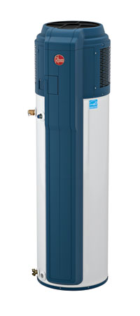

A BuildingGreen Top 10 Product: Rheem HP-50 Heat pump water heater
More than one way to heat water Rheem's HP-50 water heating options include heat pump, electricity, or both. The HP-50 has the longest warranty and lowest dB rating of all heat pump water heaters.
Image Credit: manufacturer
–From BuildingGreen’s 2009 Top-10 Products list
The Rheem HP-50 is an Energy Star-listed, heat-pump water heater with an integral 50-gallon tank. Intended for residential use, the HP-50 operates in three modes: Energy Saver mode uses the heat pump only (energy factor 2.0); Normal mode, for higher demands, uses the heat pump and one of two electric-resistance elements (energy factor 1.5); and Electric Heat Only mode relies solely on the electric elements, functioning like a conventional water heater for particularly high demands. These 75.5″-high, 21″-diameter units have an operating range between 40°F and 120°F and come with automatic freeze/overheat protection. The HP-50 comes with a 10-year limited warranty and is available through plumbing wholesalers. The Rheem HP-50 is not the highest-efficiency heat-pump water heater on the market, but it is the first relatively affordable, integral-storage, heat-pump water heater from a large national company to enter the North American market. It is also the quietest product on the market, rated at 49 dB, and has the longest warranty.

  1. dickrussell | | #1
    Situation-dependent economics?
    An air-source heat pump water heater (HPWH) will chill the air around it. This may be fine for an ordinary home in a cooling-dominated climate, but a real problem elsewhere.
    In winter in a heating climate, assuming the water heater is indoors, the heat ending up in the water will be partly the compressor work (source: electricity) and partly heat from inside the house (source: the house's heating system). One could argue that in this situation the heat source might just as well be the fuel that drives the heating system.
    In a superinsulated house, other than in winter when some heat is provided to the house, the HPWH will over-chill the surrounding area. If the area must be reheated by a heating system to mitigate the chill, where is the gain?
    It would seem, then, that any advantage of a HPWH is very dependent on the construction and location (climate) of the house.

    41 million households...
    Carl,
    These are not limited use products. 41 million households (in 2001) use electricity as their water heater fuel, accounting for 100 billion kWh or 9% of all household electricity use (http://www.eia.doe.gov/emeu/reps/enduse/er01_us.html)
    Nearly all households that use electricity for hot water also use electricity for heating/cooling, either via a heat pump or electric resistance heat. I’m pretty sure a majority of these households are in the southeast, south and southwest.
    Most electric water heaters have Energy Factors (EF) of 0.90 or 0.91. The worst performing HPWH on the market (the Rheem) has an EF of 2.0 (at 68F ambient temperature). Yes, a HPWH located in conditioned space will “rob” the space of some heat during the heating season, but they will cool (and dehumidify) a space during cooling season.
    For a typical 4-person household in my climate (central Virginia) with a standard heat pump (8.0 HSPF, 13.0 SEER) and leaky ducts (~20% duct losses), the net benefit (hot water energy savings + cooling energy savings - added heat energy) of a 2.0EF HPWH in the conditioned space is about 2,000kWh. In Atlanta, with a shorter heating season and longer cooling season than Virginia, the net benefit is closer to 2,500kWh. In Miami, with no heating season and a very long cooling season, the net benefit is close to 4,000kWh.
    You can do the math on energy cost savings for your area…for me it adds up to about $250/yr at current rates. Hardly chump change for a $1,000 product that should last 15-20 years.

    My point about it being of limited use is that it only works in the heat pump mode fully when it is installed in unconditioned space in warm climates. In conditioned space, which is where most good green buildings put their mechanical equipment, it will provide unwanted cooling in cold months and not work full time in heat pump mode. In cold climates it will not be much more efficient than a standard electric heater. It looks like an excellent retrofit product for warm climates where it is installed outside of conditioned space. At Greenbuild, the product rep said that their primary market is replacement of old units in garages in hot climates. That seems pretty limited to me.
